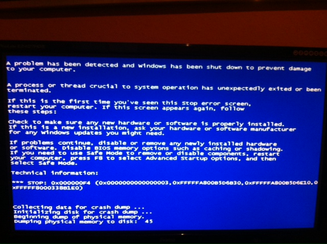

Bit of an urgent matter, would really appreciate any advice.... I've been using Skindigo intensively over the last year and a half, and now when I render an image, my computer will shut down by itself between half an hour and an hour into it. The computer screen goes all BLUE and says ' a problem has been detected and windows has been shut down to prevent damage to the computer.....' I was told this could be a result of over heating so I cleaned out all the dust inside the computer - but there was barely any as it has a good fan system... That didn't work. Then I downloaded cpu-z and gpu-z to check temperatures and they are all really low so I don't see how it could be a heating problem. Any ideas??? I had no problems in a year and a half and now suddenly the computer crashes every time mid way through the render - no matter how big the sketchup file is 10mb or 100mb. Could it be that something in the computer is on it's last legs? Hardrive burning out? problem with graphics card? It's a decent computer, 12GB RAM, good cooling system. I'd appreciate your thoughts.

Re: Render crashes after an hour every time!
Post by CTZn » Tue Jun 19, 2012 2:46 am
Is there any *.dll name reported down the blue screen ? Could also be a hardware or software driver issue I suppose.
Does this happen indiscriminately with or w/o using the GPU ?

CTZn, without sounding too much like a rookie - But I have used indigo for a year and half but haven't dabbled with GPU. I use indigo 2.4.13. Can you please tell me more about this? I have looked in my indigo settings and cannot see anything to do with GPU? Has it only come out in later versions than 2.4.13?
Below is a screen shot of the blue screen that comes up as soon as the computer crashes. I haven't added any new software recently - as the image asks so that cannot be the issue.
I am just trying to get to the bottom of this as this is only starting to happen in the last two weeks.

Just to give you guys an update... Indigo doesn't crash before the hour any more and that is down to me taking the following steps: After working on the computer all day, turn off the computer for 15 minutes, open the sides of the computer box slightly - so the hot air rises out. Turn on the computer and render, keeping the sides slightly open. This seems to work but the strange thing is that there is no over heating problem in the computer as it maintains a temperature of 37 degrees. So i cannot determine the exact problem here but the important thing is that the problem is solved (for now). Thanks guys for your input!
Noel
Post by CTZn » Sun Jun 24, 2012 1:01 am
37° is not a realistic CPU temperature at workload, that's more of the case temperature. Knowing the temperature at the surface of the CPU would help.
For instance my I7 is at about 62°C when rendering with Indigo. Opening the case helps a little, little bit (2-3°C).
