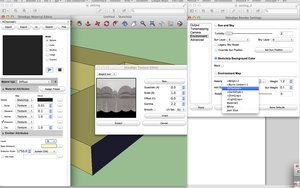

see screenshot. (skindigo_sun_mix). It does not work even if I edit in the Indigo interface.
So i did try this "workaround" : I want to have sun AND Environment illumination together.
Like here:
http://www.indigorenderer.com/forum/dow ... &mode=view
But it does not work in my version... (v3.6.26, OS X 64-bit build)
Like here:
