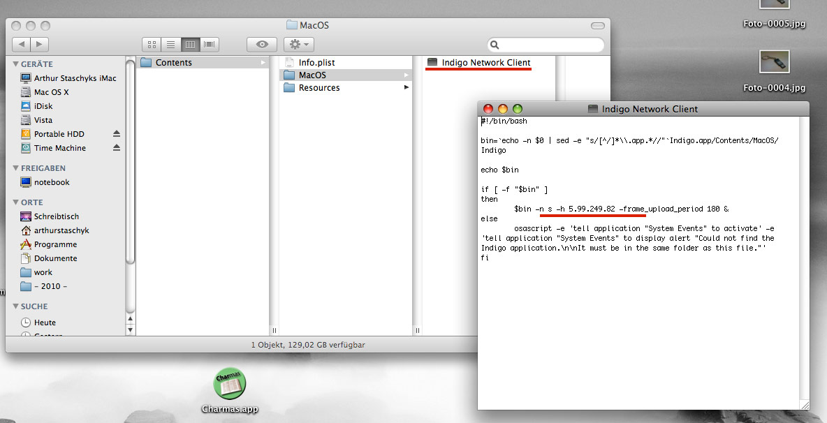

Hey Augusto,
I just made a screen shot for your IP issue:
The Screen you posted about your license:

His problem is (as seen on the screenshot) that the folder Indigo should be in is not even existant, IMO
