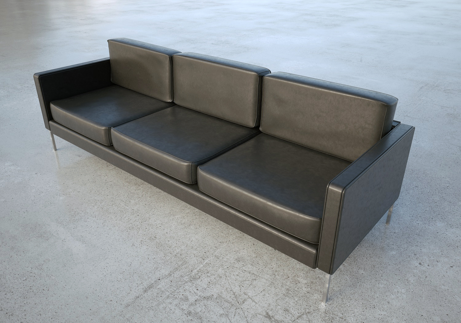

Re: Leather material help needed
I've uploaded a grey leather to the Mat Database that should be pretty close to what you're looking for. I would advise you to use it as a learning tool. Have a look at each of the images used in each slot, and the values assigned to get the result.
Have a play about with all the value and learn what difference each makes to the material. All good materials take a LOT of trial and error, and test renders to get exactly what you are looking for.
I did a VERY basic run through of what the different elements do, and how to go about making a material from scratch in this post http://www.indigorenderer.com/forum/vie ... 19&t=13003 you might find it helpful.
Good luck and keep posting!
Thank you very much Bubs for your reply and for taking the time to help me. I greatly appreciate. I will try just like you instruct me and will post my results. By the way if that is a render of a leather sofa that you posted, it is unbelievable!!! WOW!!! That's eye candy... Again my sincere thanks my friend.
No problem!
A tip for using these types of materials in SketchUp - to keep your SU file size down, open the diffuse map (colour / albedo) in Photoshop and make a low res version (for example for this leather I have a Low res version at 25% size). Use this low res image in your SketchUp model as a 'placeholder' and either set the material type to LinkedIGM if you have a saved Indigo Material file ( .igm or .pigm ) or if you are making a unique texture in SketchUp change the albedo slot from 'SketchUP' to 'Texture' and link to the high res version!
