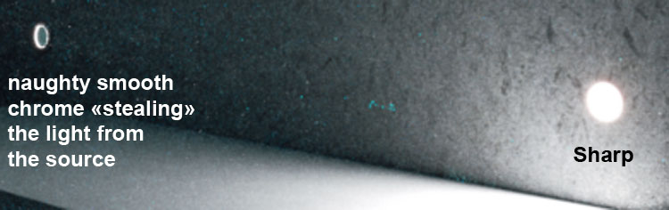

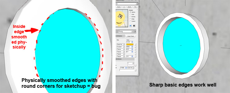

Yes indeed
Here are some photos + more detail :
It's about the 3D model, when I physically smooth the inside edges (marked in dashed red) of the collar around the light it goes crazy.
So when I sharpen them back everything works fine again..I've lost weeks trying to balance those lights in the indigo guy when it was all about modeling...
However if anyone can explain to me why it behaves this I'll be happy to hear him...I mean even if it slows down the computing process, it shouldn't "steal" the light from the source. Also I forgot to say : when I only use erroneous lights in a scene, I got really buggy behavior :

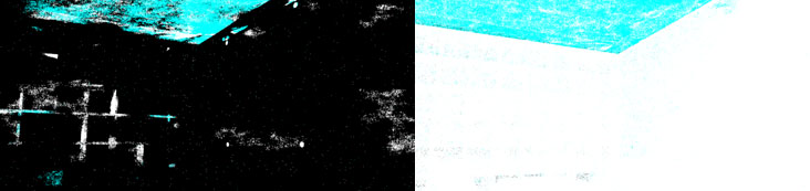

If the gain is less than 25 it's dark.
If the gain is 25+ it's too bright.
Even 24.999 gives a dark result, when 25 is ultra bright as you can see on those shots : You can imagine how crazy I got before I find this critical ladder lol...I played hot and cool during a little while until I find.
Yes indeed

Done it with blender, sent it as an obj with some old exporter that stopped being developed since 2009 and it just worked perfectly.
note this working smooth model I'm talking about is made in blender, not importer from skp then reinjected after a blender trip.
