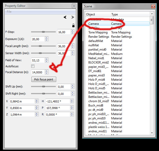

Thanks man. I cilck the reset...and I found there just two small windows left, which means that I can not change matirals right now. I click the pick material, but there is nothing happened.....and~~ is there any way that I can change fcous point during the rendering running? Thanks!

The stuff you tell doesn't make much sense for me, so here is a screenshotPowerMax wrote:and I found there just two small windows left, which means that I can not change matirals right now. I click the pick material, but there is nothing happened...
changing material:
Here you now can change the type, color and all the stuff about your material and it gets updated directly in der render window.
How about checking out the camera entry in the Scene window?!PowerMax wrote:is there any way that I can change fcous point during the rendering running? Thanks!

Hey Zom-B, you forgot to mention the right mouse clic on a panel title bar. This does reveal a list of all panels available in Indigo that you can check/uncheck. For instance, right-clic on the Scene title bar. You may find a way to the Property Editor there, PowerMax.
Also, check that you don't have multiple panels stacked in the UI: in that case, there should be tabs down them to switch between.

OMG!! It works!!! Thank you guys so much!!!! I finally did that! You guys are amazing!!
