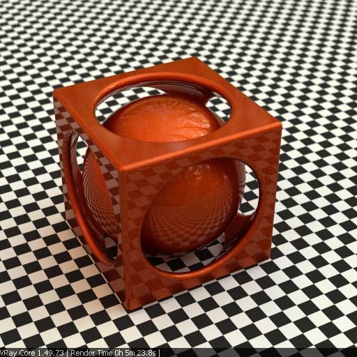

Another carpaint --> Sauce picture
For this one I want to take some more time and examine some of the other carpaints before working on this one, if you have interesting links on the subjects please send them my way :)
Again another carpaint --> Sauce picture
I adjusted the rgb value of the red carpaint to get this one (and on IOR value as well).

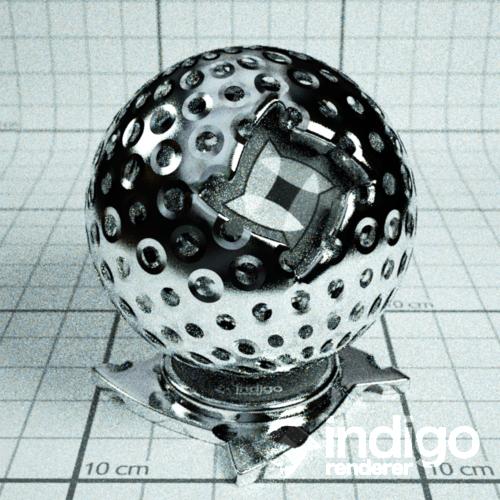

Perforated metal --> Sauce picture
Blend mat of al.nk (phong) and a null using a blend map, and a bump map on the phong. It would probably be better to remake this as a shader to make the size of the holes a variable, but I don't know anything about ISL so...

Post by OnoSendai » Sun Jun 21, 2009 6:06 pm
Here's a perforated metal shader. The actual shader controls the blend factor, for a material that blends between null and metal. Please excuse the noisy render, working on an old laptop here :)

Re: Borgleader's Material Emporium
Post by Borgleader » Sun Jun 21, 2009 6:12 pm
Cool stuff :) (was going to render it but...I cant preview external mats it seems)
Post by OnoSendai » Sun Jun 21, 2009 6:13 pm
I'll add the bumped edge of the perforations to the shader first :)
Post by OnoSendai » Sun Jun 21, 2009 6:32 pm
The shader with a slightly exaggerated bump effect around the perforations:
Maybe I will write a tutorial on how to make regularly repeating shader effects such as these.

For the orange carpaint - try and use some kind of map that has a lot of dots (noise map?) so that it has some speckle to it, instead of just being a flat color? :wink:

Post by CTZn » Tue Jun 23, 2009 12:12 am
OnoSendai wrote:Maybe I will write a tutorial on how to make regularly repeating shader effects such as these.
Exposing ISL code is already of a great help, and with comments it's kind of a tutorial !
Could you post the last shader of yours Ono please, I'm wondering if you used a lerp or something, not to mention the how.
Btw thanks for the circle ;)
Borgleader, I like your copper version more !
Post by OnoSendai » Tue Jun 23, 2009 12:37 am
Here's the shader for the bump-mapped perforated metal:

I've been trying to geta speckle effect onto the orange carpaint and so far...the problem is that I cant generate a blend map that looks good.
