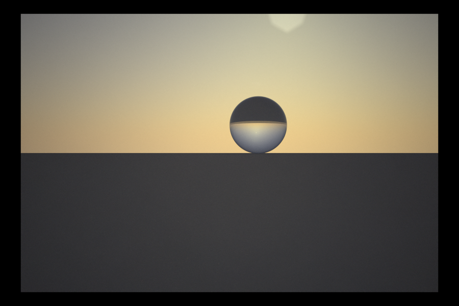

This is a test I did, inspired by another lens test in this forum. The light in the upper part is a flare.
Indigo 0.7t5

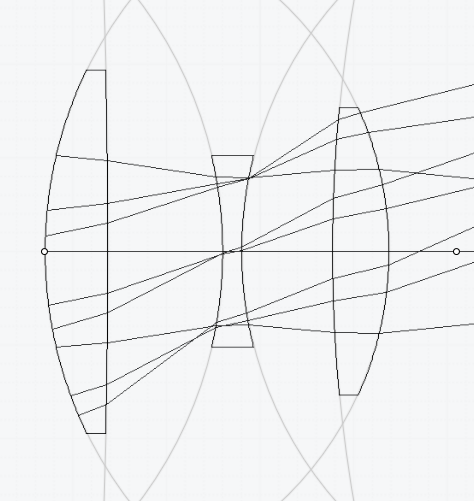

Construction. Cooke Triplet, 50mm
Result
manitwo
Posts: 1029
Location: Tirol - Austria
Post by manitwo » Sat Mar 31, 2007 9:04 am
unbelievable clean :shock: rendertime?
superb flare!
Post by Kram1032 » Sat Mar 31, 2007 9:26 am
yeah... really clean...
looks like an inversed reflectioning ball, instead of a transparent ball...
ryjo
Posts: 68
Joined: Tue Jul 04, 2006 6:16 am
Location: Pluton
Post by ryjo » Sat Mar 31, 2007 9:55 am
This is the latest entry from the log:
Time elapsed: 47h, 32m, 3s
Done 9932600000.00000 samples (18393.70370 samples per pixel)
58043.58855 samples / second (17.22843 micro-seconds / sample)
Shutting down...
:roll:
But it looked pretty ok after about 10 h.
In order to set the focus I moved the image plane to 48.5 mm (it ought to be about 50 mm).

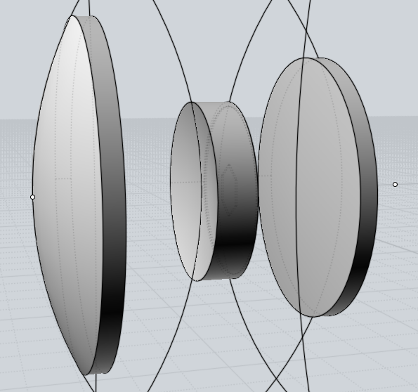

Post by ryjo » Sat Mar 31, 2007 9:10 pm
IanC wrote:Wow, that's amazing! I never managed to get a decent image out of it.
How hard was it to alight the lenses? I could never get the focal point right (I think) with simple lenses, so decided not to go for the cooke triplet.
Hi,
The way I did it was to take an image of the design and then reconstruct based on this. I added circles that "overlapped" each lens surface, and then generated spheres from these circles. Using CSG i could make the three lens elements. Then I added an aperture behind the middle lens (where the aperture stop is). I exported the lenses (and a box) as obj and did the xml by hand.
Each lens is about 35000 vertices.
There is this program, zemax, and the demo has some example designs.
Edit: The theoretical focal length is 50 mm for this lens, but that came out blurry in the tests, so I adjusted the image plane to 48.5 mm, which is what is rendered.
Spheres
Profile of construction.

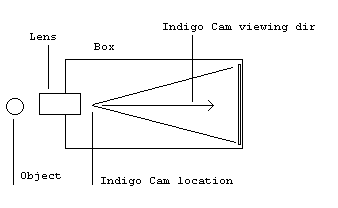

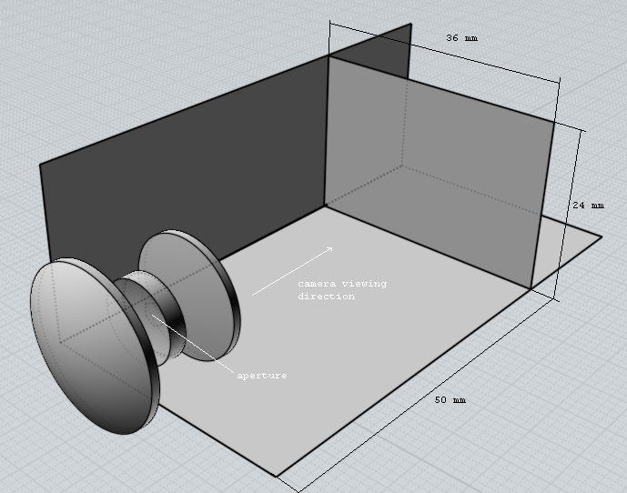

Post by ryjo » Mon Apr 02, 2007 9:54 pm
8bstudio wrote::(
Great....but I don't understand how you use your lens project instead the camera in Blender for example!! Can you explain me please!!
Hi,
I don't use Blender, but I'll try to explain how to set up set camera: The indigo camera is placed inside the modeled camera and is pointed towards the rear end (opposite to the lens, at the front). The rear end must be diffuse white (1,1,1), all other walls in the box must be black (0,0,0). The lens will project the world outside the box onto the white screen. Set the FOV of the camera so it captures the screen (back of the box), but no the walls (they will just be black). See layout.
Hope this helps!
One additional comment: In order to focus the image plane (back) must be moved slightly. For focus at infinity move i 1.5 mm closer to the lens. For focus on something closer than that (say 5 metres), move even closer. This is trial and error process (even though there are some equations...)
Layout

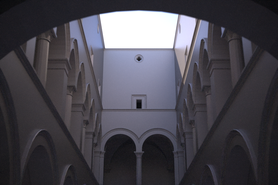

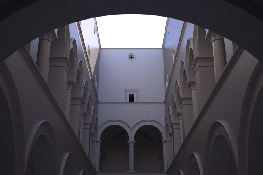

Post by ryjo » Wed Apr 04, 2007 6:49 am
This is another result of using the simulated camera. The cleaner image is the reference pic (rendered with indigo camera only).
The "simulated camera" image is left/right-flipped.
Time: 20h / image.
The model is the sponza atrium.
Indigo Camera only (reference)
Simulated camera (same as earlier)
