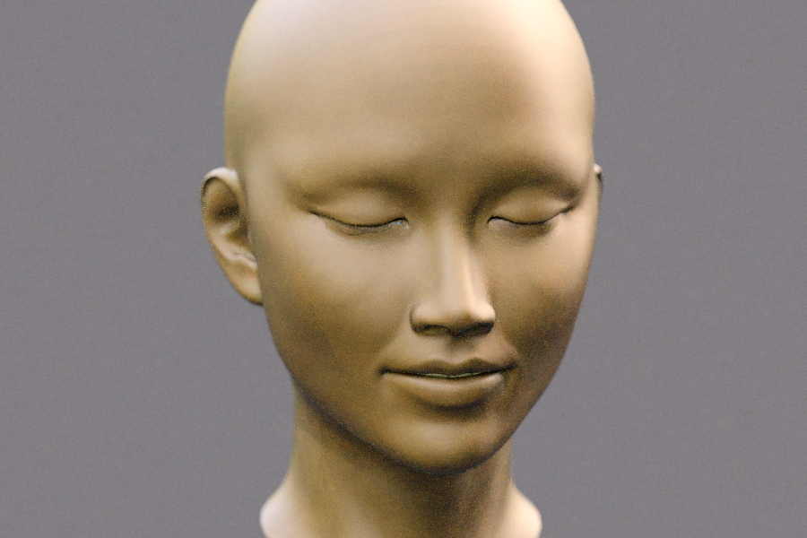

Hello,
Here is a head with epidermis/dermis surface/medium:
settings
melanin_fraction: 0.5
melanin_type_blend: 0.5
hemoglobin_fraction: 0.001
epidermis surface: glossy transparent, exponent: 10
This was done using two mesh surfaces, one for epidermis and one for dermis. The dermis surface has the vertices translated in the direction of the vertex normal by -0.25 mm (the thickness of epidermis).
Post by Kram1032 » Sun Feb 11, 2007 6:34 am
Very nice pic!
Only the teeth appear... yellow^^
The mesh looks a bit Asiatic, but the colour of the skin is more like n middle or north europe
How is it lit? Sun?

Post by ryjo » Sun Feb 11, 2007 6:43 am
Very nice pic!
How is it lit? Sun?
I don't know why the teeth are yellow, they are defined to be diffuse white. Maybe reflection from the skin?
The scene is illuminated by an env_map (exr).
Post by Kram1032 » Sun Feb 11, 2007 6:46 am
Maybe, the thickness is wrong at the eyelids, since they are very thin. Also the Eyes may give an other SSS value... But it looks quite realsistc, nevertheless...
ryjo
Posts: 68
Joined: Tue Jul 04, 2006 6:16 am
Location: Pluton
Post by ryjo » Sun Feb 11, 2007 6:58 am
Yes, the thicknes of epidermis is 0.25 mm for the entire figure, which is too much for the eyelids. But its a test.
The skin tone was taken from the spec, page 5, lower right example, middle image:
http://graphics.ucsd.edu/papers/egsr200 ... 06skin.pdf
Post by Kram1032 » Sun Feb 11, 2007 7:14 am
Mhm, this skin examples are quite useful
I think, noone has a skin with 20% hemoglobin. It looks very unnatural..
Maybe, you should decrease the melanin blend beta/m value (This should make the skin look more asiatic, like the mesh...)

Post by ryjo » Sun Feb 11, 2007 7:25 am
Yeah, I could try a different setting. Thanks for the input!

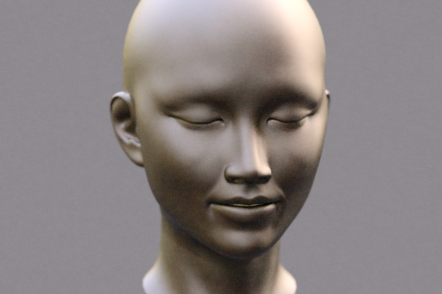

Here is a render using more asian skin tone (see page 7 in the spec). The teeth look more white now.
The camera setting is 200mm lens, which may cause the ears to look bigger.
melanin_fraction: 0.15
melanin_type_blend: 0.0
render time: 1h15m
Post by Kram1032 » Sun Feb 11, 2007 9:06 am
Yes, that's better^^
But: What are these edges in the skin? Is it, 'cause you didn't render it as long as before, this time?
ryjo
Posts: 68
Location: Pluton
Post by ryjo » Sun Feb 11, 2007 9:11 am
Kram1032 wrote:Yes, that's better^^
Do you mean the patterns visible on the forehead? Those are more visible the longer the render goes, this has rendered about 20 mins longer. It is a low res model, ~55000 vertices.
