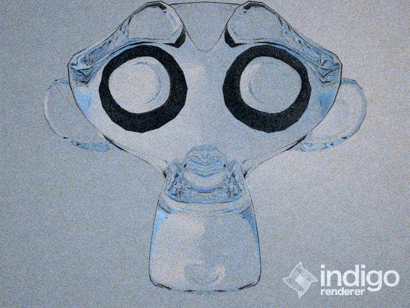

I've been fixing up blendigo for 2.0 and have become quite an accomplished modeller.
