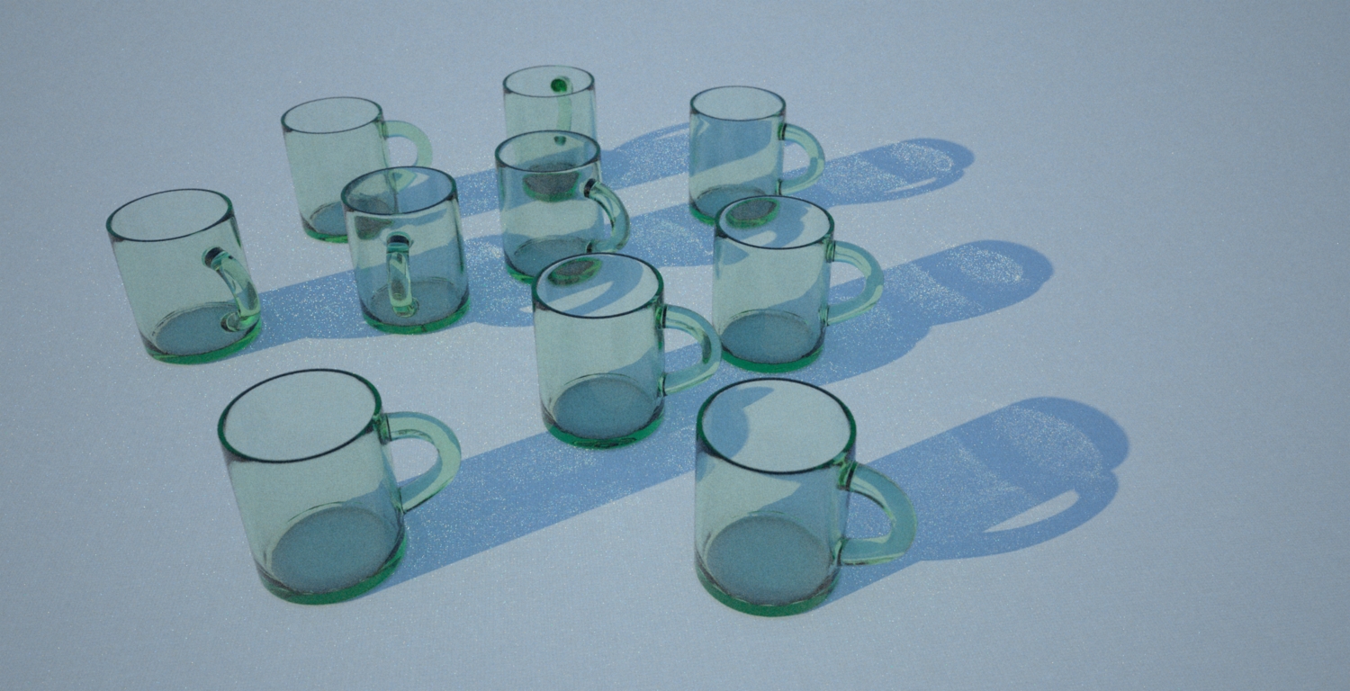

Post by neo0. » Sun Feb 22, 2009 6:32 am
Something I made last night...
Post by Kram1032 » Sun Feb 22, 2009 9:25 am
do I see normal problems in there?
Post by PureSpider » Sun Feb 22, 2009 9:41 am
Where? I don't...
Post by Kram1032 » Sun Feb 22, 2009 9:46 am
around the top and the bottom of the glass-cups and the handle-ends.... (normal / normal smoothing)
WytRaven
Posts: 905
Location: Dubbo, Australia
Post by WytRaven » Sun Feb 22, 2009 11:01 am
Looks like it needs more polys and detail around the rim. The edges are a bit sharp there neo. Grab a real glass and look really close at the rim and model accordingly. You'll see what I mean.

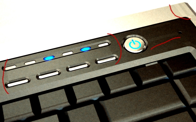

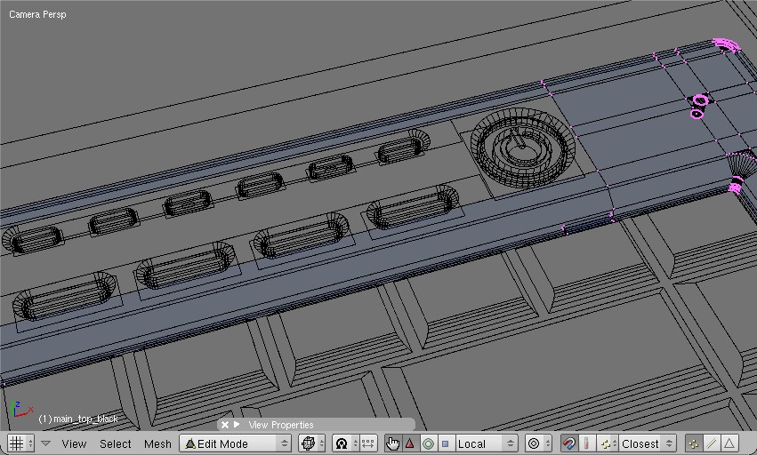

Post by SATtva_ » Mon Feb 23, 2009 4:29 am
I'm modeling a laptop, and there's something strange going on. As you can see on the first image, some faces look a little more bright than the rest (I've pumped up contrast and outlined these areas on the second image). And I can't figure out what causes that effect. Materials are uniform on these surfaces, normals smoothing is off, all areas are flat, there are no slopes which may reflect light in other direction.
Could the ray_origin_nudge_distance be the cause of the problem? Because the model has many very tiny details, I had to set it to 0.000001 to get rid of other artifacts like disappeared polygons.

Post by Psychotron80 » Mon Feb 23, 2009 4:53 am
using subsurf modifier on that surface?
SATtva_
Posts: 179
Location: Russia, Siberia
Post by SATtva_ » Mon Feb 23, 2009 5:09 am
Nope, no modifiers at all, just a bare mesh.
Edit: Ah, thanks for the question, Psychotron80, it lead me to look more thoroughly through object settings, and in Blendigo under Mesh menu I found that Subdivision Smoothing is turned on (no idea when I turned it on actually). I'll try to test render again.

Post by Psychotron80 » Mon Feb 23, 2009 5:29 am
glad to be of help! that could well be the problem, it could have a similar effect as Subsurf...
but I'm soo n00b I cannot say!
SATtva_
Posts: 179
Post by SATtva_ » Mon Feb 23, 2009 6:04 am
It's awful, shame on me. :[[[[ The cause of the problem was in fact the ray_origin_nudge_distance. But the real reason was me setting it to 0.000000, not 0.000001 for that particular rendering!
This looks much more sane:

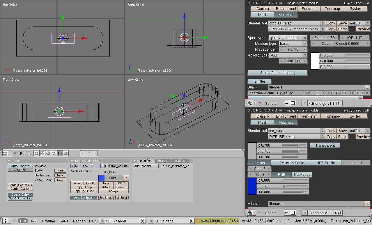

CTZn and all interested in LEDs:
I spent several hours trying to make this damn thing real. Below I'll attach geometry and material settings (I hope non-Blender guys could figure out proper settings for their exporters).
There are a few tricks here. First, orgglass_matt material (shown below) is for turned off LED. For turned on LED glass is just a diffuse transparent material with RGB of 0.8. However, used for turned off LEDs diffuse transparent makes them too dark.
Second, as you can see below, there is a plain mesh intersecting LED glass. It must be any white material. For turned off LEDs it makes them really white from the light backscattered in glass.
For the LED light I used gain value, but I think Luminous Emittance (lux) could be used as well. However, Luminous Flux of even 1 lm makes LED burned to white.
