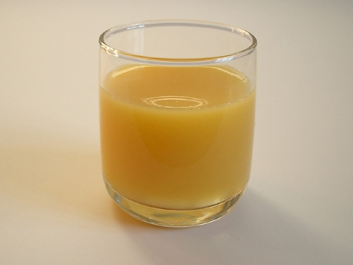

YAOJR:
Rendered to about 15K spp. Using the material settings I posted earlier (not the material from the MDB). I think this material is a bit more accurate than the one I uploaded to the MDB
Also, a PHOTO of OJ for reference.
Yet Another Orange Juice Render
This is a PHOTO of orange juice for reference

Whaat, I definitely like this material. Looks pretty realistic to me!

Whaat:
I think in your last render, the glass medium has too much absorption, at least compared to the reference image.

OnoSendai wrote:Whaat:
Actually, my absorption for the glass medium is zero.. :? I suppose there could be normal smoothing artifacts from not having a smooth enough mesh. I have been meaning to render this scene with an older version of Indigo to see if some of this is due to the self-intersection code that was changed.

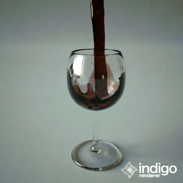

OJ is still not clear, looking dirty... I am @18600ssp at the moment.
I also tried pixies merlot from the matDb on the laptop. Looks ok to me, but perhaps a little bit more red component? It is also not finished yet, but hey, this is supposed to be a "test"-thread!

@ Polinalkrimizei: That's a really cool liquid scene! I think with some tweaking it would make an awesome liquid preview scene. Would you mind sharing the .blend?
All the liquids look a bit strange as they splash inside the glass. I wonder if your meshes are intersecting the glass properly and if the precedence settings are correct?

@ Whaat: Thanks! I'll share the .blend tomorrow, I'm at another computer right now. The liquid is intersecting the glass properly, but the precedence of the orange juices was wrong indeed!! :oops:
And I wondered why it looks so bad... :lol:
So I'll share the .blend tomorrow with the liquid as a mesh, and in case anybody wants, the liquid as a already-set-up-fluidsim. Whaat, do you have the power of the 64 bits? I can't calculate the fluid more accurately cause of mem restrictions. Higher resolution = cleaner fluid mesh! Anybody interested?

Re: Liquids Test Thread
Post by CTZn » Tue Jul 14, 2009 12:38 am
Yes, and if you can't run the simulation at an higher resolution, at least Indigo can subdivise the mesh further, this should be a reflex every time you need more triangles to render !
Curvature threshold should be a key parameter in this case.
edit: and the glass top edge profile curve shoule be made of 6 points at least to avoid bad modeling artifacts :P ;)
