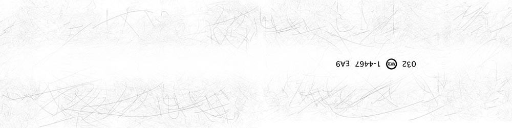

The texture is 9000 x 2250. It's only that large because the scratches need to be very very fine to look at all realistic.
The gold ring has 24,480 quads. I could probably get away with less around the circumference of the "tube" where most are used for the slightly convex inner surface but the 360 divisions around the ring circumference are definitely necessary to ensure a perfectly curved edge. Could probably get it down around the 12k quads if I could be bothered doing it now :P
BTW that is not the actual final map. I was just using that image to get the UVs done. The final map looks (well one of the two) like this:
Obviously massively reduced in size :) Each ring in the rendered scene has it's own slightly different map; different serial number and different scratching. The maps are seamless along the short edges only as the long edges are hidden behind the silver rings.

PureSpider wrote:Photoshop brushes? Clever usage of some fonts?
Serial and maker's mark were all done with fonts. I chose the main font because it's very simple and is similar to the one used on my real ring. The mark font is just a simple serif font and the ring is an alchemy symbol from an alchemy font :D
After rasterizing I just did a little selection transformation to break up the uniformity a bit, which is something I noticed on my wedding ring, and did 3 or 4 simple box blurs to get an ever so soft edge (with a lower res map you would probably only do one to avoid softening the edge too much).
The two rings have consecutive serials :)
It's mirrored on both axis' 'cause I couldn't be stuffed moving my UVs along the X axis and inverting along the Y...it was easier to do the "fixing" in photoshop :lol:
Also a note on this map: The horizontal centre of the map is less scratched on purpose as this is the inner ring portion which gets naturally polished by rubbing on the skin :D ...just in case you were wondering :lol:

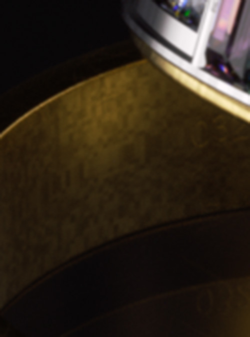

Ok I'm convinced there's a bug in Indigo with small polygons. That weird patterned noise on the inside of the ring renders exactly the same when no textures and no HDRI env map is used.
I thought maybe it was just some feature that was slow to converge but after 20K spp on my current render it is still exactly the same. I will leave current one going for another 20 or so hours and see if it changes but all signs are pointing to "not a freakin chance". :roll:

Zoomed in example image so you can see what I'm referring to.

Did you notice the pattern is mirrored?
Dunno what that shows, just wanted to mention it... :?

Purespider, yeah I see that, I also see the numbers from the makers' mark. I wonder if the texture is still on there somehow?

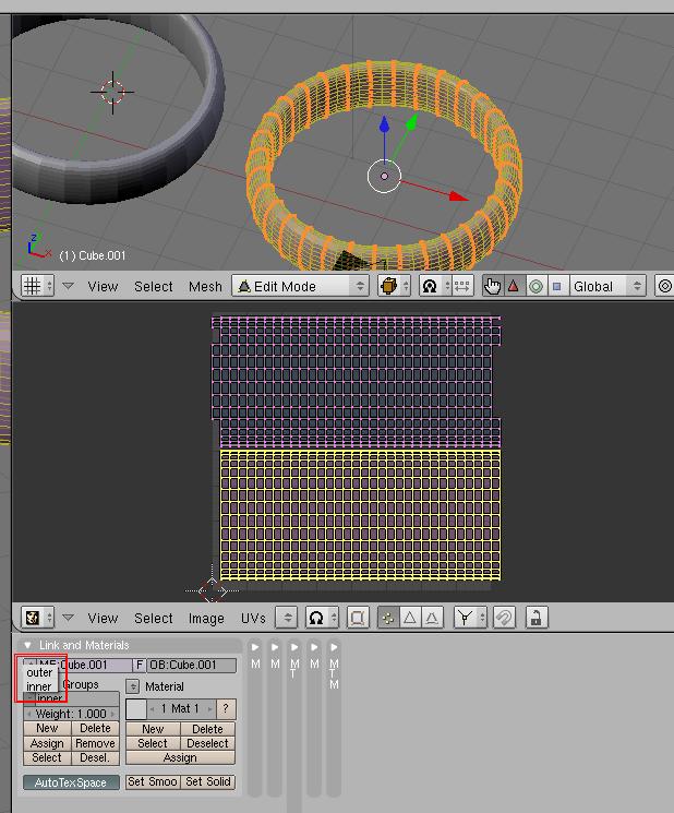

Actually polina's method works well with vertex groups, one each for the 'inner' and 'outer' sections of the ring. Unwrap them separately. No tweaking was done besides moving the outer uv group down.

dmn wrote:Purespider, yeah I see that, I also see the numbers from the makers' mark. I wonder if the texture is still on there somehow?
Yes the texture is on there. This is from the current render. I previously tried with no textures and no env just to see if that was the problem and the results were exactly the same.
By the way, now try that unwrapping method on a mesh that is not evenly distributed round the "tube" of the ring.
Render is currently at 30K spp with no change...

Hi Wyt, the pattern bug is due to a self intersection issue.
I've made some changes to the code already, so hopefully this should be fixed in the upcoming 2.0.10.

OnoSendai wrote:Hi Wyt, the pattern bug is due to a self intersection issue.
Ah well that's a relief just knowing what it is. Thanks for the update. I'll wait for 2.0.10 before wasting more electricity rendering this thing again ;)
