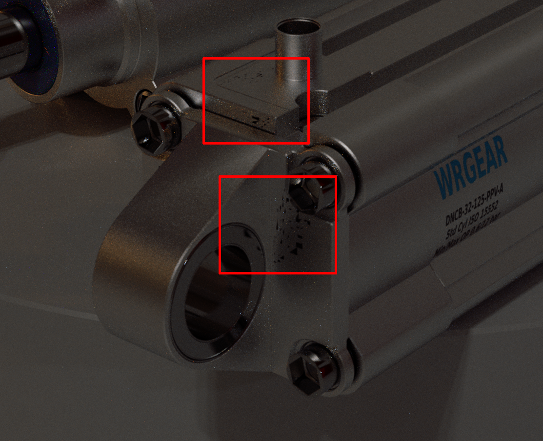

Odd Artifact
Post by WytRaven » Fri Jan 09, 2009 10:47 am
Anyone got any idea what is causing this odd artifact under Indigo 1.1.15?
At first I thought it was just due to changes in the way indigo renders since the last time I did any rendering of these objects (back on version 0.9 i think...) but after about 48 hours and no change to the black spots I'm starting to wonder if this is some sort of bug...
The material on the effected parts is aluminium nk data modified by a bump map which simulates very fine mold dimples...that's it...nothing "special".
Post by Kram1032 » Fri Jan 09, 2009 11:17 am
It's a known bug... something with the KD-tree... simply set the now missnomed BIH-threshold (or is it already the BVH-threshold? :? ) to 0 to fix it. Poorly, the render will be a bit slower, but not as much slower as with old BIH :)

Ok Kram I set bih_tri_threshold to 0...it's not a bit slower; it's more like half the speed. msps went from 26 to 56 :shock:
...but it does fix the problem :?

I'm wondering if that bih issue is not just because the affected faces are coplanar with bounding boxes sides, see what I mean ? Try to give a small rotation amount to the whole scene with bih, and see, coz it's an untested fix (if any) :oops:

This is sure to be wrong, but did you try without the displacement map, or lowering the adaptive subdivision on the mesh?
EDIT: Oh, you said bump map. Try turning that off?
Post by PureSpider » Sat Jan 10, 2009 5:52 am
Its 100% not related to bump or whatever.
This is a KD-Tree error...
Post by Zom-B » Sat Jan 10, 2009 6:17 am
Herea bugreporting thread for this issue!
Anyway, your speed drop down from Kd-tree to BVH is realy creapy!!1!
The slowdown should be minimal :?
How much polys?

Post by WytRaven » Sat Jan 10, 2009 11:29 am
CTZn: I'll try rotating and see what happens. Won't this just move the problem though? I mean stop it occurring in those places but cause it to appear in others?
dmn: I can't turn off the bump or the object will look completely unrealistic :?
PureSpider: That is encouraging due to the above response to dmn.
ZomB: Creepy and for me painful...I've gone down to 10 samples/pixel/hour! :shock: The only change was switching bih_tri_threshold from about 50000 (or whatever the blendigo default is) down to 0 :(

Post by WytRaven » Sat Jan 10, 2009 11:31 am
Zomb: Poly count (blender quads at least) is 276,688.
Post by CTZn » Sun Jan 11, 2009 12:21 am
WytRaven wrote:CTZn: I'll try rotating and see what happens. Won't this just move the problem though? I mean stop it occurring in those places but cause it to appear in others?
Forget what I said, the issue is related with bih and the geometry, even while the later is of clean/simple topology. Modifying the geometry would just move the issue around the mesh. This is a severe bih bug wich I could work around only by redoing the geometry, and I don't see this as an option in your case, WytRaven :/

Post by WytRaven » Sun Jan 11, 2009 12:26 am
Thx CTZn :)
I've just bitten the bullet and am rendering with bih_tri_threshold 0. 6h 16m - 106spp :cry:
Estimated time to arrival (at my desired 10000spp) aproximately 24 days :shock: ...this is insane :x Ono help me! ;)
