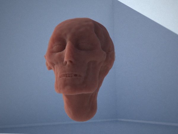

SSS is such a great feature, yet, i think, hard to handle.
i tried around to achieve skin quality by hand. i am not too far, but getting closer.
somehow the dermis and epidermis stuff didn´t work too good for me.
i know that taking the model of a mummy is not the most adequate thing for sss, but that was what i had ready for testing. the model was done in blender. i will rework the teeth, once i have the skin shaders correct.
i wanted to see the pure sss, without any shininess and stuff. i will post my progress, if anyone is interrested.
looking at the ear to the right shows, that everything is quite transparent at the moment.

:shock: wow ! ... would you mind sharing your xml-material?

The material looks so perfect I could touch it.
Posts: 6243
Post by OnoSendai » Wed Feb 14, 2007 3:58 pm
That dude is real ugly :)

I second Manitwo!!! plz plz, xml material! ;)
I second ONO, that guy scares the shit outta me! :shock:

sure, thanks for the replies.
It´s pretty simple though, main thing is the ior = 1.
<medium>
	<name>scatter</name>
		<basic>
			<ior>1</ior>
			<cauchy_b_coeff>0.0</cauchy_b_coeff>
			<absorption_coefficient_spectrum>
				<rgb>
					<rgb>6 36 50</rgb>
				</rgb>
			</absorption_coefficient_spectrum>
			<subsurface_scattering>
				<scattering_coefficient_spectrum>
					<uniform>
						<value>30</value>
					</uniform>
				</scattering_coefficient_spectrum>
				<phase_function>
					<uniform/>
				</phase_function>
			</subsurface_scattering>
		</basic>
</medium>
<material>
		<name>skin_test</name>
		<specular>
         		<transparent>true</transparent>
         		<internal_medium_name>scatter</internal_medium_name>
      		</specular>
</material>

Cool head !!
Do u plan to texture it ?
Cheers

yes i plan to texture it. but first the basic skin depth has to be correct.

Ok, for the depth try an higher value for <scattering_coefficient_spectrum> and use <glossy_transparent> instead of <transparent> to use an ior value higher than 1 (ie: between 1.3 and 1.5 i think) but there are some energy loss problem with this setup.

Can we use texture map with SSS material?
Suvakas
not right now...
But it would be useful...
I just have to work out how to do it, probably some kind of local modulation of the absorption coefficients (similar to what Jensen does)
