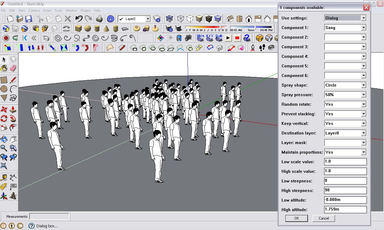

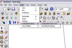

Thanks guys. Attached is a screen cap of the component spray window. After installing this plugin, it can be accessed under the draw menu. You can also watch it in action here http://www.youtube.com/watch?v=_JI_erjwGFM
In order to use this in conjunction with instancing in skindigo, you can refer here http://www.indigorenderer.com/forum/vie ... 7&start=45 On how to use dummy instancing go here http://www.indigorenderer.com/forum/vie ... php?t=2215 Cheers!

Jeff wrote:Thanks guys. Attached is a screen cap of the component spray window. After installing this plugin, it can be accessed under the draw menu. You can also watch it in action here http://www.youtube.com/watch?v=_JI_erjwGFM
Wow, where did you get all those extra buttons on top?

They're little files that you can usually download for free that can augment the existing tool set with new abilities. If you're looking to download some and find out about them, I'd visit the Sketchucation site http://sketchucation.com/ and read a little about them.
Skindigo is a plugin, actually. And you should have that button already, right?
