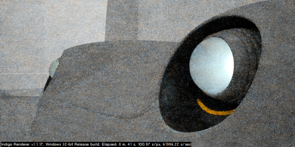

Well, I make a lamp in the headlight with emit at 20 lm and a light blue. The glass is a basic glossy transparent fix at 2000 exponent and 1.33 IOR. Its color is white without subsurface scatering.
The tonemap is reinhard.
But I'm not completely satisfied. Do you have some ideas to give me??

Re: Xenon Material
Xeon lamp is ~3500 lm
U may use fog for cool effect, but it's very very slow.

Re: Xenon Material
Hi SuperIndigo, basically an headlight is made of three elements: the lamp, a deflector (mirror) and a glass lens.
Before you are happy with those, you should remove the fog, it's not helping you.
You can easily create a deflector from a cone or hemi-sphere (cut at equator); select one edgeloop each two and move/scale them in the proper direction to make sort of stairs.
If you want to see the caustics effects, first (remove fog and) put a white diffuse plane in front of the headlight.
Reinhard is good for shapes previz, you should better not use it to calibrate lighting.
I'm adding this image, savagely linked from
http://images.google.fr/imgres?imgurl=h ... f%26um%3D1

Re: Xenon Material
Oh oops I was deceived by the dull tonemapping, my bad. Looked like an uniform phase function for subsurface scattering.
