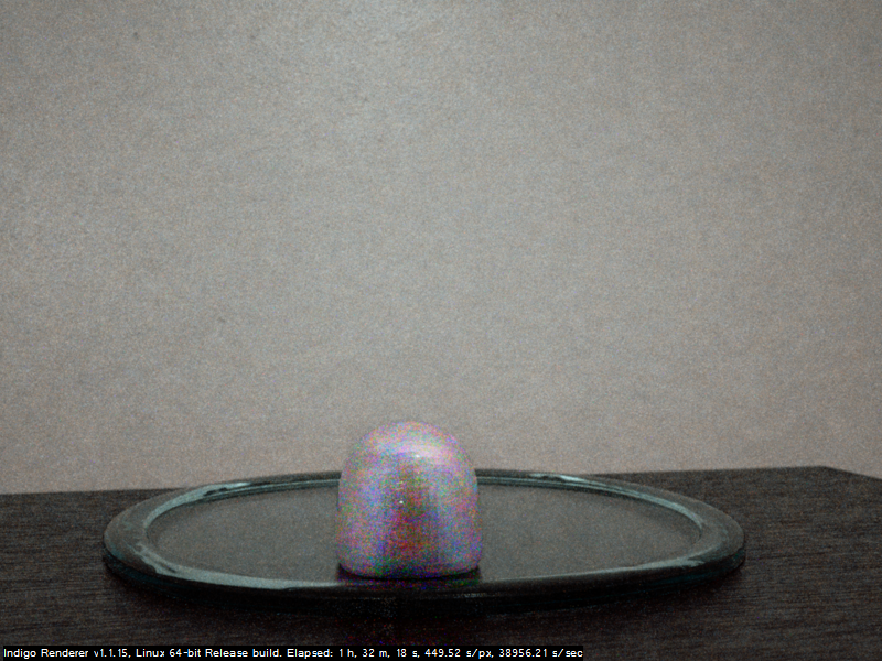

I'm trying to make a glass of milk. I used the settings seen here...
http://www.indigorenderer.com/joomla/fo ... light=milk
but after almost two hours on a triple core (almost 500spp) it's still wonky. It looks like smoothing isn't enabled and the whole thing is horribly discolored. Am I not waiting long enough? I know the color thing is fairly normal, but it looks like I can see the individual polygons. I'm posting this here, because I figure sss might have changed a lot since that thread... if anyone has a better mat, maybe you could post it? Thanks.
I'm using Blender 2.48a, blendigo, Indigo 1.1.17 Linux x64.

Post by Borgleader » Thu Jan 22, 2009 11:23 am
Looks like you forgot to press "Set smooth" on your mesh. Did you set a cauchy coeff?

Post by cookieofdoom » Thu Jan 22, 2009 11:42 am
It looks exactly like I forgot set smooth... but I didn't. That's what's confusing me. I didn't set a cauchy coeff... should I have?
Post by CTZn » Thu Jan 22, 2009 12:20 pm
Milk is slow enough so that you want to be sure that your geometries are ok... wich doesn't seem to be the case. Test the mesh with a simple diffuse; probably the smoothing issue would stay the same: redo then the shape.
Milk is slow no matter what, its absorbtion is rather low (energy remains high longer) while the light is sent from bounce to bounce within the medium in a frenetic fashion, I guess it is finding an exit more hardly than it would with lower scattering.

Post by cookieofdoom » Thu Jan 22, 2009 12:53 pm
Alright, I'll let it render a bit longer. I didn't get that effect when I rendered it as just a normal mesh, so I'm guessing it's just an illusion and it will go away after a bit. If it's not gone after 3-4 hours, I'll post back... I may try using the preview scene, too.

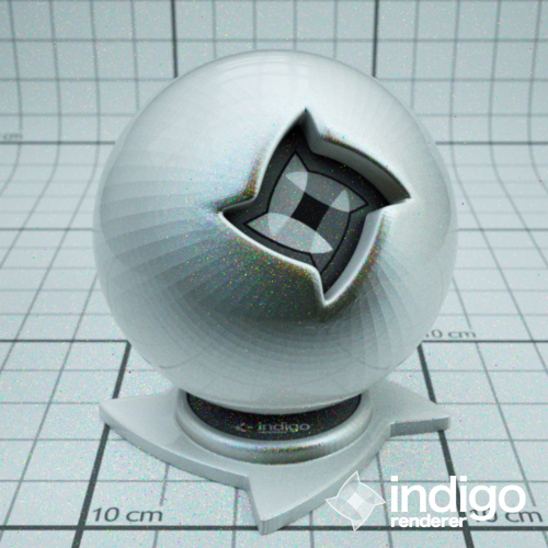

Yeah, rendering so much background for a test shot was pretty dumb, I realize. I used the matDB preview scene and I got the attached. I'm starting to think it's a bug? Maybe I should try Linux 32 or Windows 64 versions?
Well this is odd.
Post by PureSpider » Fri Jan 23, 2009 5:09 am
I know of this behavoiur like forever... never considered it a bug though...
I have my own material preview scene which works just awesome with milk... so I think the medium is not the problem
