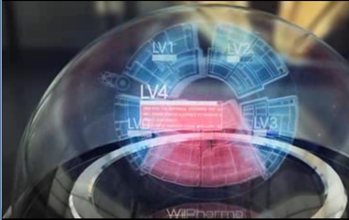

Post by neo0. » Sat Jun 28, 2008 8:45 am
Somethign like this
Basically, a material that is somewhat transparent and glows..

Post by neo0. » Wed Jan 14, 2009 12:40 pm
How about something a little simpler.. A color display embedded in glass?
http://www.youtube.com/watch?v=jPauljzA ... re=related

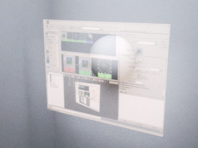

Another example of a hologram is attached. If a new material type is needed (say "transparent glow" or something) then I think it would make a valuable addition.

the screen is totally invisible (it does not interact with light), even not casting shadows. Only the light it is emiting is visible. As such it's also the perfect candidate for laser beams.
edit: I'm insisting on the fact that, as a specular, this material will only work on closed meshes (volumes). Here I'm using a shrinked cube, it's no plane.
screen is a thin sheet (volume)

Post by neo0. » Mon Jan 19, 2009 9:17 am
Would it be possible to create a colored holo material..? See attachedd

Post by neo0. » Mon Jan 19, 2009 9:59 am
Instead of using an texture, could could theoretically just use geometry apply the mat to it, right? I mean, I think thats what they did in those CG movies that I took the pics from.
