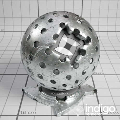

Hello there,
I really would like to do something more "ISL-ist" with this material.
http://www.indigorenderer.com/materials/materials/1513
But this way of "think" at the contrary of that I know, and my poor knowledge in the ISL basics cause me a lot of waste of time and frustrations.
Because I understand that is simple example, and I feel like an idiot when I don't succed to re-do this simple exemple like I want, and this so easy to do that in bitmap with Substance or Photoshop...
Could you please help my to place me on the way to understand this example:
http://www.indigorenderer.com/materials/materials/154
