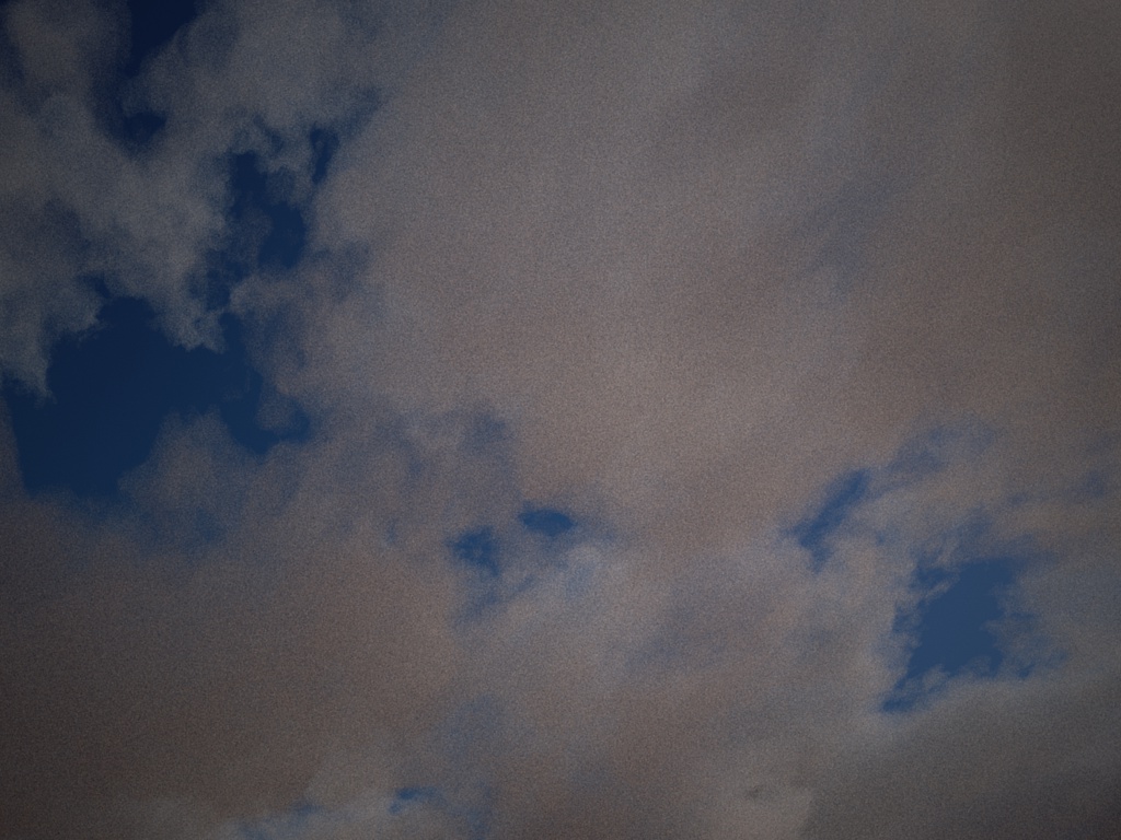

This is the slowest clouds I ever rendered ^^
on 1920 x 1440 I have 56k samples/sec per machine...
My result also look different then yours CTZn.
Here a example after 45min on 3 machines reaching 145spp:

Zom-B: you are rendering using the cumulus phase function while my render is on uniform because I edited the shader after the scene was loaded. The cumulus phase function will provide the most realistic renderings of clouds but it is several times slower than with using the uniform one. The ground color bleeding must be affected accordingly.

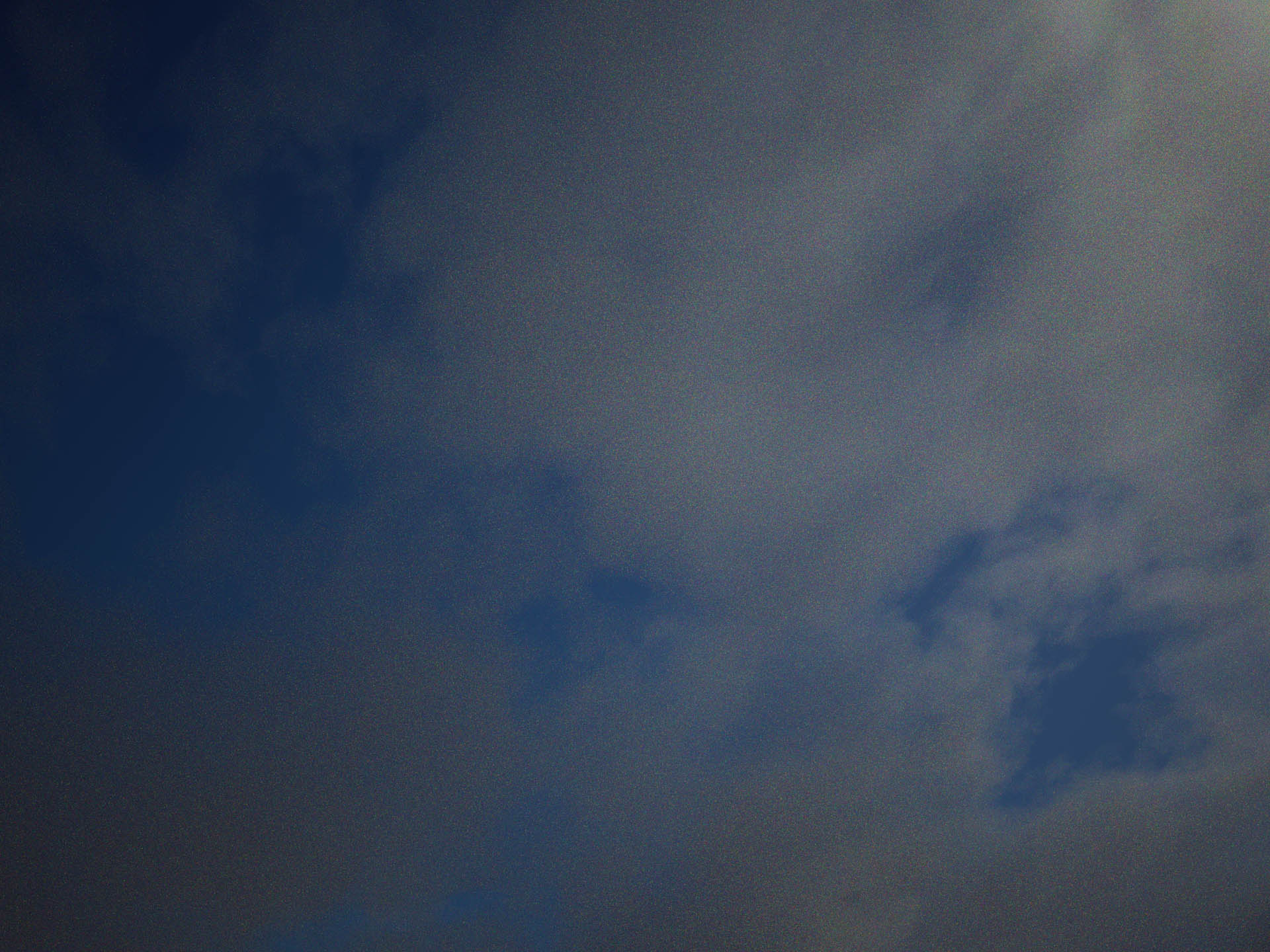

Finally had the chance to play around with it.
Especially dig the characteristics scale and layer amount results. Higher scales give pretty nice results for hero clouds.
Did only some quick tests with combining different sorts on different heights and put some cauchy on some as well just to see what happens.
The only thing I noticed is that the edges start refracting sort of when they intersect. Is there a way to deal with it? One could combine all meshes to avoid intersections, but that would defeat the purpose of having different cloud types on different levels.
Attached an example with Max Extinc. Coefficient 0, as the effect happens also when they are transparent.

Hi kklors, thanks for your time and for the pic.
Thank you for pointing the border issue out too, since I never tried several intersecting volumes I wasn't aware of it. I am supposing that MLT is favorising this behaviour but that I'll check on myself. Convergence is key, as we know
Cauchy is in question too...

Ah yeah not a big issue. Happens in all render modes.
One could place the intersections in a way so they won't take over too much and paint them away in post later.
If there's an easy solution to avoid it, would be good to know though : D

late answer but as it comes out, the cauchyB parameter is applied evenly throughout the whole volume, regardless of any shader specification.CTZn wrote:Hi kklors, thanks for your time and for the pic.
Thank you for pointing the border issue out too, since I never tried several intersecting volumes I wasn't aware of it. I am supposing that MLT is favorising this behaviour but that I'll check on myself. Convergence is key, as we knowCauchy is in question too...
