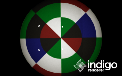

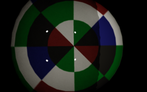

OK, so I finally put together some test scenes that better illustrate my issue. I have two images here, a solid sphere encapsulated in a transparent sphere. In the first image the transparent sphere is small and creates a thin layer of glass around the solid sphere. In the second image the transparent sphere is much larger and creates a thick layer of glass. The apparent light loss, or color change, is the same in both cases. I would expect the color shift to be dependent on the thickness or radius of the transparent sphere but that doesn't seem to be the case. I'd like to create a smoother transition between the clear and solid surfaces if possible.
In the process of experimenting with this I noticed another strange anomaly. If I enable displacement mapping on the transparent surface the position of the specular highlights shifts slightly to the left, even if the displacement value is set to zero. Based on the equation in the manual I would expect to see no change.

For the transparency issue, try rendering using BiDir and glass acceleration turned on (or with the new beta release, use arch glass option on your transparent medium)

Glass acceleration doesn't seem to help much for curved glass. The new arch glass option helps the color, but removes all of the refraction caused by the transparent surface.

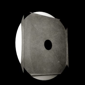

It could be scale. Here is the glass 200mm*200mm*4mm, scale 1
scale 1000, so the glass becomes four meters thick
