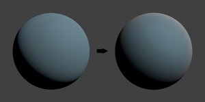

Ok so for the scene I'm working on I need a rather specific "material" which I think is only possible using shaders, and since I've never actually written one before, well here I am
((Yes I did check the manual's examples))
Basically I'm looking to make an "atmosphere" type shader which I think would go something like
Pseudocode wrote: a = dot(normal, lightVector)
b = 1 - dot(normal, viewVector)
c = (1, 1, 1, 1)
return a*b*c;
or at least I think this should yield what I'm looking for, however I don't know if we have access to this type of information in ISL.
((Added a visual reference of what I'm going for))
Left: Simple diffuse, Right: Simple diffuse + "atmospheric shader"

It looks to me that you want to code a brdf and not a shader in the sense of indigo ( but in other domains such as direct3d or OpenGL one would call this a shader)
This is not possible actually with indigo as you cannot acces to light and eye vectors
It is not possible to write the brdf in isl, just the albedo which is quite different ( for instance, a lambertian diffuse material has an albedo which is independent of incoming and light vectors, while the brdf has a dot product form)
You may try minCosTheta()*(1-maxCosTheta()) * c
Or maxCostheta()*(1-minCostheta())*c
However, what do you want to do visually? From this it would be more easy to help

It may not be so obvious on the picture but basically the material/shader should be transparent where the normals are facing the camera and should gradually become opaque at the edges.

Borgleader wrote:It may not be so obvious on the picture but basically the material/shader should be transparent where the normals are facing the camera and should gradually become opaque at the edges.
Ok I got it. Ctzn, the idea here is not to fake it by making it an emitter, but more a semi transparent diffuser with falloff.
This is a diffuse material at grazing angles and a null material at normal incidence. It's absolutely not fake.
However, not possible to do it with Indigo without faking something, as this is clearly a custom brdf material. It would require additional coding of indigo.
The possible fake I can imagine will have one drawback : energy loss.
Do you want to model it as a separate sphere which is slightly larger than the planet sphere, or directly integrated in the planet surface material? In the second case it would not suffer of the energy loss problem but then you cannot use bump or phong on your surface or it will look weird.
In the first case, define a blend of null and diffuse with for instance 80% for the null. Then make an albedo shader equal to one of the above equations

galinette wrote: Do you want to model it as a separate sphere which is slightly larger than the planet sphere, or directly integrated in the planet surface material? In the second case it would not suffer of the energy loss problem but then you cannot use bump or phong on your surface or it will look weird.
Etienne
I want it on a separate model, because the final planet will in fact be 3 different layers: surface, clouds, atmosphere.
