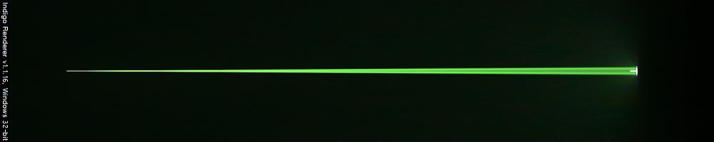

Post by Lord of the Rings Junkie » Wed Jan 28, 2009 3:04 am
Well, I'm getting close. I'll have to tinker some more to get the collimation tighter, though.
The width of the peg at the wide end of the beam is the target beam diameter at 1 meter. I'm using a set of two lenses to collimate, but it seems VERY sensitive to the shape and thickness of the lens. I've resorted to making fine adjustments to the IOR of the lens material itself, so we'll see how it goes.
Once I get good collimation, the next step will be acceptable power. The render you see uses linear tone mapping with a scale of 5*10^9!

Oh, okay -- you're using a lens-based collimator. When you said "collimator" I was thinking of the sort used for x-ray beams -- a tube with a grid in it (see http://upload.wikimedia.org/wikipedia/c ... imator.jpg). My concern with that was, of course, that most of the light would be absorbed, but you won't have that problem with lenses.
If you're using lenses, the lensmaker's equation might help you (see earlier post) to figure out where to put the light source relative the lens. Note that that's for a lens with an arc-shaped cross section (i.e. a spherical lens).

Lord of the Rings Junkie wrote:The render you see uses linear tone mapping with a scale of 5*10^9!
Light normalization ftw!!!
Try to define your lasers flux by your self, if you don't, Indigo does! And the smaller your lightsource, the smaller the flux Indigo uses for this light!
a flux of 10000 is me fine with the most tonemapping like camera & linear... but camera settings are important here too... f-stop & Co...

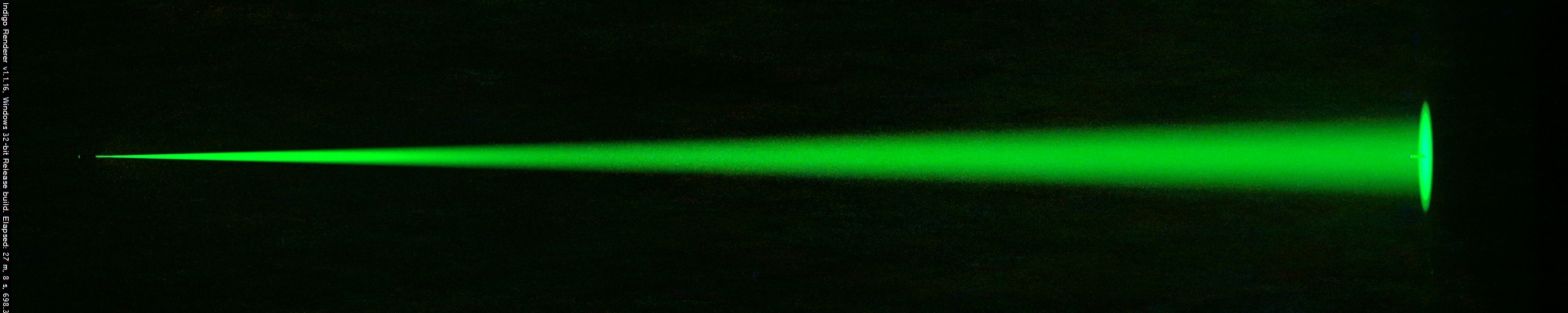

I'm continuing my tests, but I thought I would provide my .blend file so that other people could take a crack at making a lens collimator as well. The following render shows the raw, uncollimated beam emerging from a 0.5mm aperture with a divergence of approx. 3.5 degrees. The peg at the target indicates the desired beam width of about 2mm at a distance of 1 meter from the aperture. The collimating lenses should probably have a diameter of about 2mm as well.
Layer 1 of the blend file contains several cameras and fog to make the beam show up. Layer 2 contains the laser itself and the target geometry. Let's see who can do it first... :)
indigolaser.zip
(776.55 KiB) Downloaded 430 times

The best collimation results I've seen with indigo were from high res paraboloid reflectors I think...
