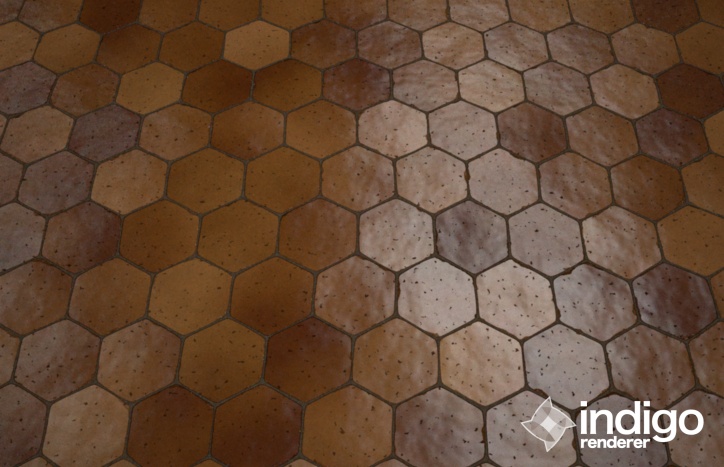

Here is the last version:
Edit : picture updated with less noise

When I saw the last render test I thought at the first moment I was looking at the real pictures of terracota I posted few days ago. They are very real like, so congratulations again! I would only say if you permit me, that there're too many black little holes on the tiles...

That's strange : the material editor is not including the texture in the pigm, I thought it should?

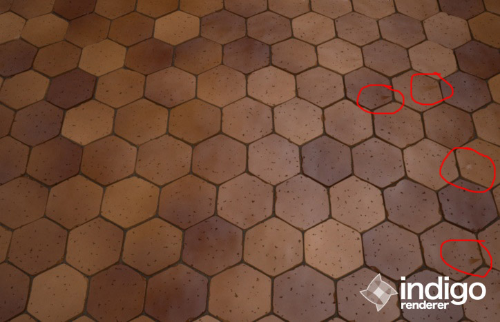

Here is the last screenshot. I tried to follow CTZn's advices, and added some displacement (previous was 100% bump). The displacement adds a lot of realism I think. However, there are some artifacts due to displacement : some strange triangles, mostly in the right part of the image. Could this be due to the blending of displaced materials??

Post by galinette » Tue Feb 16, 2010 9:11 am
Anybody has an idea where this may come from? It appeared when I enabled displacement instead of bump. It looks like the normal is not properly computed.
That's annoying, since the tiles are looking good now apart from this :(

Post by Soup » Tue Feb 16, 2010 10:13 am
yeah I saw that.. it's not a subdivision thing is it?
