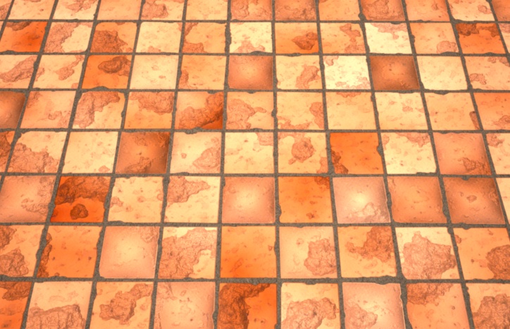

Re: Full-procedural ceramic tiles material
Last screenshot : still some strange look to fix (way to much bump I think) and the exagon to implement
Some terracota tiles actually look like brick. But anyway color is customizable by changing a 2D gradient texture.
Etienne
You rock
Sadly I'm too worried about the bugs I'm generating on Maya to "have fun" with Indigo
I'll pay myself a bit here, playing the smart ace. On damages (based on ceramic-test.jpg):
Basically the threshold is too low, making too large grooves.
You could add a "wear" parameter based on the tiles displacement shader (that would fit better for floors tho):
outer tile -> more wear -> less octaves(/depth) for grooves. You can even add the grooves shader to drive those octaves, deeper -> less wear. e: Uhm, or a copy of the shader, or that wouldn't evaluate I suppose.
There is often dirt accumulating around the grooves borders, below the tile surface.
You can keep the UV placement for grooves homogeneous over tiles, but play instead with a per-tile grooves threshold (grooves average width). This way the damages would be related from tile to tile without being outrageously aligned.

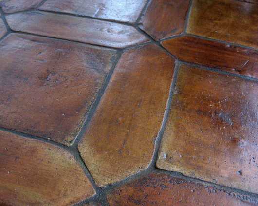

Here is my last test on terracotta. Now I will work on the base terracotta material itself, as the geometry & tile damage is quite OK I think.
Awaiting your suggestions!
Etienne
Etienne
You are on your own Etienne, we are left behindAwaiting your suggestions!
So... go galinette go !
What is your reference material ?
