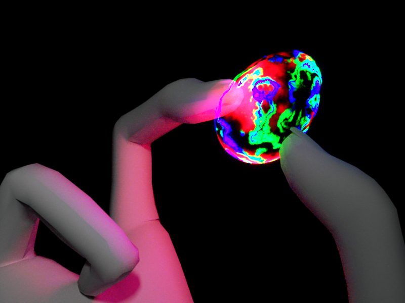

neo0. wrote:Instead of using an texture, could could theoretically just use geometry apply the mat to it, right? I mean, I think thats what they did in those CG movies that I took the pics from.
As in the first image for instance ? Yes of course, though I think they rather used a shader based on facing ratio with camera, plugged into incandescence (this is biased slang) on top of an incandescent texture. Incandescence in biased renderers does not necessarily means emission of light, but it means the material is visible wether ligthed or not.
Yes of course
This is at least my actual opinion, given the (poor) example I produced, and how I understand it is working within Indigo. I will confirm or infirm those says shortly, with resulting images in the first case.
Anyone willing to do so before me is welcome :) I'm slightly busy at other things...

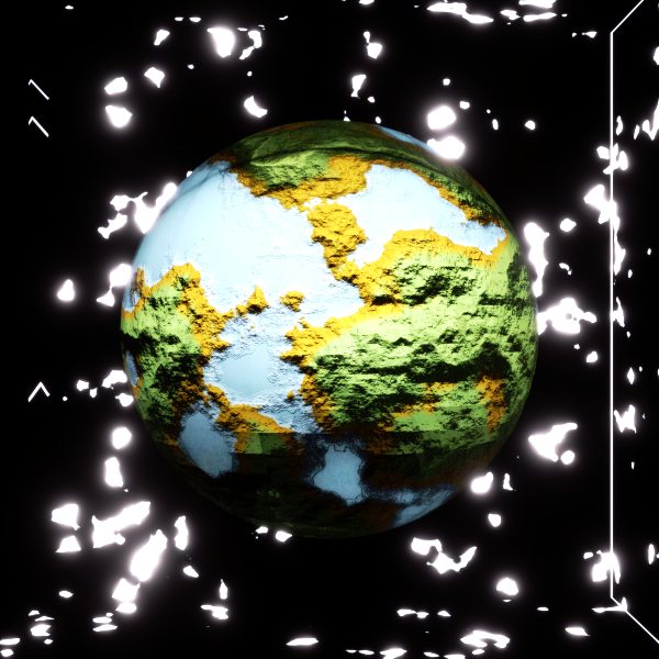

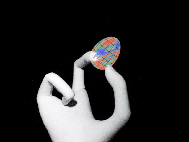

This one out of the box 8) MtI test scenes:
... and he is living on this planet. The border edge of the universe is because I didn't bother touching default UVs, just a press and go setup.
This guy is holding the very first local reproduction of the common terran egg
Post by Borgleader » Wed Jan 28, 2009 12:30 pm
The shadows on the planet are weird...forgot "set smooth" or....wtv the maya equivalent is?
Post by neo0. » Wed Jan 28, 2009 1:33 pm
Very nice work, ctzn. :)
Post by CTZn » Wed Jan 28, 2009 2:25 pm
Well yes that's an issue Borgleader, but its also just a test scene. While coding I lost control on sphere primitive and I used a default maya sphere, low res that is.
Also one can see a texture artifact circling upside, it's a limitation of the old, actually used texture sampler with some 3d textures. I wish the mental ray sampler will be used in the future (32bit output, yummy!). When it's on I'll add displacement too ;)
Thanks for the nice comment neo0., you are my friend now :)
Actually I'm redoing the egg texture in a less boring fashion... before a break x°x
Here I am (or I'm schyzophrenic or it's absolutely me using hyper saturated textures :mrgreen:):
