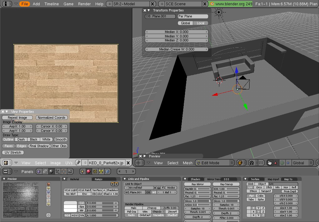

New error message(Error: SceneLoaderExcep: ObjectExcep: No such uv set 'UVTex' (In element 'model', around line 17447, column 5) heres a screenshot

the imported material you took from the MatDB has <uv_set> to uv.
Change this value in the igm to default and it should work :)

Post by Borgleader » Tue Jul 21, 2009 9:32 am
@3dGeek: ZomB beat me to it. Its simpler to call your Blender uvset "uv" instead though, i think.

Post by 3D Geek » Tue Jul 21, 2009 9:34 am
o thanks, it worked! :D
