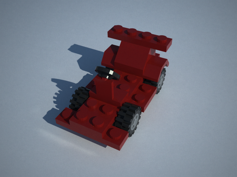

Post by Fencer » Fri Sep 26, 2008 5:21 am
ok here we are 8)
Post by PureSpider » Fri Sep 26, 2008 5:43 am
That's what I've come up with (though I did that test some time ago)... Is that what you'd like to have?

Post by Fencer » Fri Sep 26, 2008 5:57 am
yes thx. what were your settings?

Post by Kram1032 » Fri Sep 26, 2008 6:33 am
I see...
you seem to have used a diffuse...
use a specular, turn up red and green a bit (green just a tad) and use pretty shallow IoR and medium Exponent... (1.2 IoR and 1000 Exponent or so) That's a first idea :) - maybe even lower IoR... and if the bricks are supposed to look entirely new, therefore higher exponent.)

Post by Kram1032 » Fri Sep 26, 2008 8:02 am
you know what? it's the diffuse light! That's the problem... those mats are phongs... You can't see that they are. They all look diffuse...

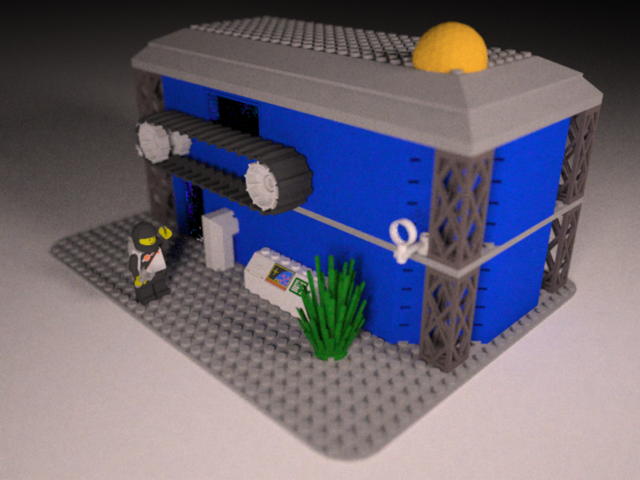

Post by Kram1032 » Sat Sep 27, 2008 2:02 am
Not seeing lines between one row of bricks and the other bugs my eyes somewhat xD
Though, that's a far better example, as light conditions make it easier for the eye to decide, whether the colour is correct or not :)
