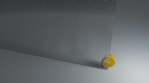

I started by doing displacement but ended modelling the glass. I did it in cinema 4d, but I can send you the model if you give me the dimensions you're planning to use

bidir test
vs
path tracing on gpu diffuse depth 12

Indigo is the renderer, I used Cinema4D for modelling. I tried texture, but modelling gave me not only a better result, but smaller memory usage in the end. Once I got the desired effect on 3D, one might create a displacement texture out of it.

Post by pixie » Tue May 06, 2025 8:29 am
This time I baked the geometry into a normal map, what you see is just a normal map applied to a box. It might be all that you want.
