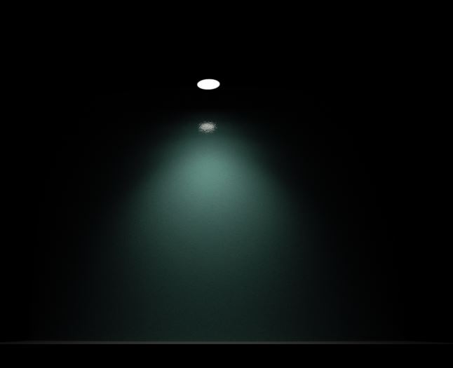

Hey this is cool! Managed to mess it up initially though, I just added this line:
And then I engaged my brain and removed the def eval code and just added the code exactly as FakeShamus had noted and I get this: Which is much better!

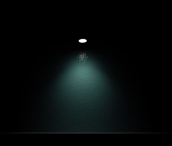

So with a little bit of fiddling, I get this: Which I think is just about right (aside from the colour which I will tweak). The bump won't be so obvious when the material is in the rest of the scene and properly lit.

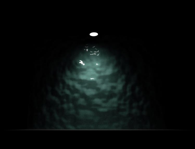

underneath the def eval which was already filled in like this:noise(posOS()*100)*0.0001
And ended up with this: Which is cool but wrong!def eval() real : fbm(posOS()*4.0, 2)*0.02

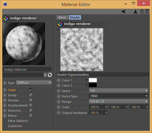

This is a "simple" GUI that controls some ISL Shader parameters inside C4D.Oscar J wrote:WTH! Why does Indigo not have that?

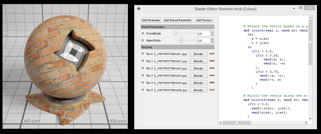

Indigo does have something like that, but for that some artist/coder needs to setup the material nicly in the first place!
Like the material in this thread: http://www.indigorenderer.com/forum/vie ... 23&t=13032
