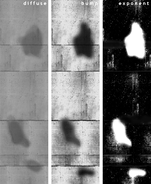

Nick, ANY texture can be used as a bump map.
As Godzilla said, you could set the bump drop down menu on "SketchUp" and you'd get almost the same result as if you converted the SU texture to greyscale in PS.
The PS passage helps you to make the texture more suitable for your needs, adjusting the contrast, the levels, the brightness. This way, you can optimize, select, accent the bump (or the specular) zones at your will.
I attach the maps used for the floor mat in my memorial scene.
I hope this clears up a little their usefulness.
