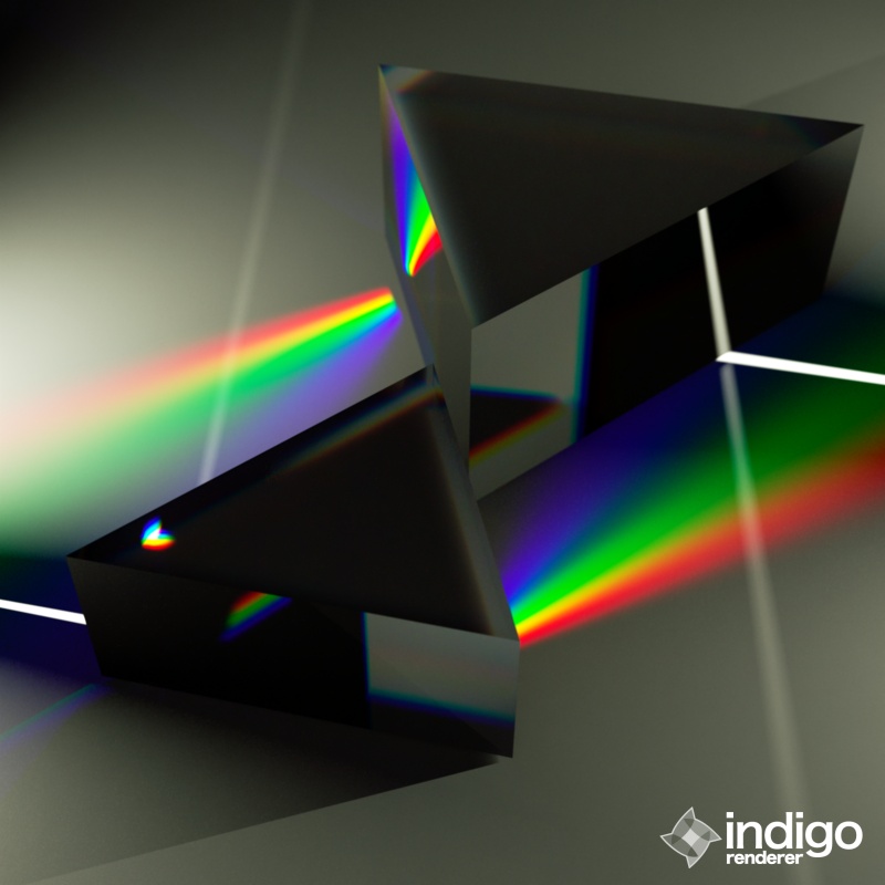

I am curious to know a few things about creating a nice dispersion scene. For example:
How do you create the beams of light?
What are the material settings for the prisms?
Any other tips for setting up the scene?
If you have created a nice dispersion scene, please share it (preferably in an editable format such as .blend) so we can learn from it. Thanks.

This is very simple.
Beam = a small light source inside a narrow closed space - one end closed, one open (like in the end of a tube or smth)
Prism material = specular glass with cauchy_b_coeff > 0 (larger values mean more saturated colors of spectrum)
That's it.

I am having more trouble creating this scene than I thought. I am not getting a nice rainbow effect. I have a prism that is about 2 inches across. Does the size of the prism matter? How big should the light source be? How big should the hole in the tube be? I have cauchy set at 0.003
Also, should the prism be sitting right on the ground or should there be a small gap (>0.2mm) between the ground and the prism?
Any other suggestions or tips? Could someone share a scene that works for them? Blender or SketchUp formats are welcome.

Here's my scene.

Thanks for the awesome scene godzilla! I want to use it in a SkIndigo tutorial to show how to set up a dispersion scene (if that's ok with you)
Here's the result out of SkIndigo:
The first time I rendered it, I used MNCR=5000. However, I got some fireflies so I re-rendered at MNCR=1000. Notice the difference?

- MNCR=1000 What's missing?
- dispersion.jpg (92.13 KiB) Viewed 67239 times

A second rainbow is missing on the upper prism.
