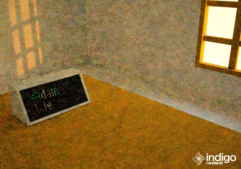

My apologies for the lack of examples. :)
The first one here was done with turbidity set to 6 (the max is 7.5) and with the time of day set to 5 AM.. I wold have expected it to be pretty dark but yet the sun seems really bright.
After that, I set the time of day to 11 PM and maxed out the turbidity. The sky was no longer a bright yellow. Instead it was white.. But still.. Isn't it dark in most places at 11 PM?

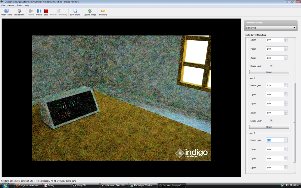

I tried setting the sun to layer 2 and the sky to layer 3 (the screenshot with the indigo ui) and turned both down to almost null, and yet the brightness didn't seem to change at all

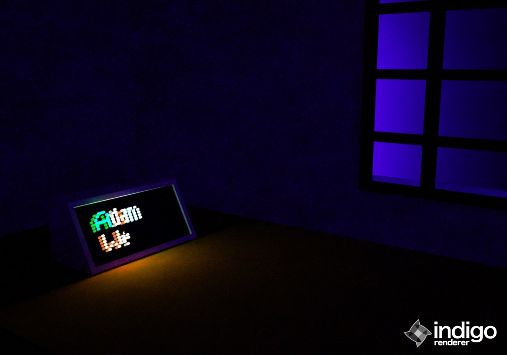

Post by neo0. » Thu Oct 08, 2009 4:34 pm
Well, thanks to the suggestions, I think im up and running :)
as i wander.jpg (117.97 KiB) Viewed 23538 times
Re: Night time scene
Post by Pibuz » Thu Oct 08, 2009 7:11 pm
Neo0, be careful because if you set a late evening time in SU, indigo sky will behave atipycally, producing some non-physical mostly violet-shaded shade. I tell you because I see a violet light ouside your window..
Post by neo0. » Fri Oct 09, 2009 11:18 am
Yeah, noticed that too.. Is it just because indigo can't simulate physically accurate times of day beyond the standard night time and day time?

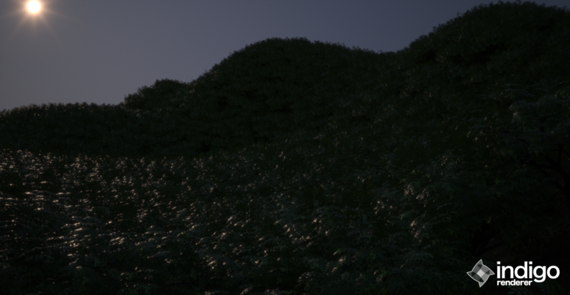

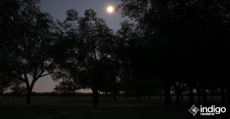

I am not sure if this is of any help, but when the sun is placed within an image with tonemapping set to Reinhard (auto-exposure), the scene would look like a moon lit evening when rendered.
