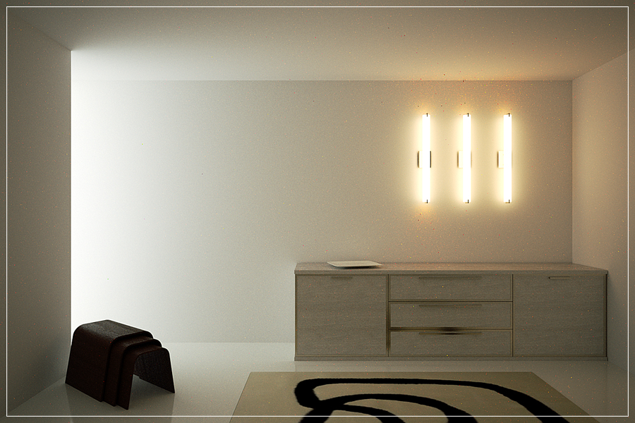

Post by Pibuz » Fri Feb 13, 2009 8:32 pm
Thank you a lot Whaat!
I just downloaded this latest release, and gave it a try just to get a little more used about the new workflow and stuff. I set up a really simple scene and the result after a night of calculation is attached.
There are two light layers (a simple emitter behind the corner and the three lights in front), no specular materials. The light material of the three tubes is assigned directly to the cylinders. The spp reached has something astonishing: 1750 in 8 hours or so. :shock: I don't know if it's because of the simplicity of the scene, but: :shock:
I mean, if that's not clear, that i expected the rendering process to be much slower than it turns out to be, using layers! I absolutely have to add something specular, now..
Btw, i noticed some kind of artifacts around the cylinders, some red spots that are not supposed to be. Perhaps it's a little bug or something. Sadly, I don't have the scene any more. The server just deleted it for it was on my desktop.. :?
So here it is. :D :D :D
These are the little red dots
Here is the test! I tried to apply a little displacement to the carpet but i think it's too smooth to be visible. Gonna test on another scene asap
interior test.jpg (497.02 KiB) Viewed 21987 times
Post by Zom-B » Fri Feb 13, 2009 10:43 pm
Pibuz wrote:The spp reached has something astonishing: 1750 in 8 hours or so. :shock: I don't know if it's because of the simplicity of the scene, but: :shock:
Actually this doesn't seem to be very fast ^^
But for interiors it maybe fine...
Just a hint about Light Layers:
Indigo does use some weighting on how much samples each layer gets. This weighting is related to the LuminousFlux of the light Layer!
I don't know if this is simply in %, but if a layer has a much smaller luminousFlux than the other(s) you can see very nice in the GUI that it evolves slower then the other(s)
The Red dots seem to be evil :evil:

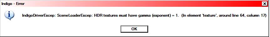

Post by crojack » Sat Feb 14, 2009 6:34 am
I tried it as an external material under diffuse and phong and I get this error.
I saved the material and opened it in a text editor and this is it-

Post by Whaat » Sat Feb 14, 2009 7:04 am
so change the gamma to 1.0 and see what happens.... :)

Post by CTZn » Sat Feb 14, 2009 9:45 am
Pibuz wrote:These are the little red dots
Let's call a cat a cat: I believe that fireflies are a natural consequence of using bidir, say often. I know two ways to reduce their impact if I may:
- Post-process diffraction will fail with fireflies. It is responsible for the colored dots. A single firefly, without post process, concerns a single pixel.
- MR_cubic as SPLAT filter (default settings) is likely to fail as well, outlining fireflies. MN_c is recommender as downsize filter.
Hence the third hint:
For production use super sampling along with the forementionned tips, then apply post_process diffraction in a resuming session.
edit: post process filter seems to be applied before reduction, wich makes sense quality wise but ehances fireflies and takes more time to compute. [REQ-non SKIndigo specific] I suggest to add an option to force post-proc filter after resizing.
Hope that helps !
