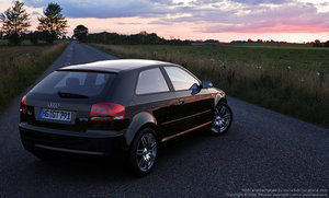

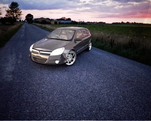

What I can't seem to find out is how to use back plates correctly - for example see below, every render you see of a car on a road, the car looks like its actually on the road with all the correct lighting etc - how is this done? How is the car made to look like its actually on the surface, when I'm assuming its a back plate image? See the images attached for what I mean.
So I've got the free sample from here http://www.hdri-locations.com/ which comes with all the backplates and the HDR file (which I have converted to an EXR file). Can anyone give me a simple walkthrough on how to use them both effectively?
