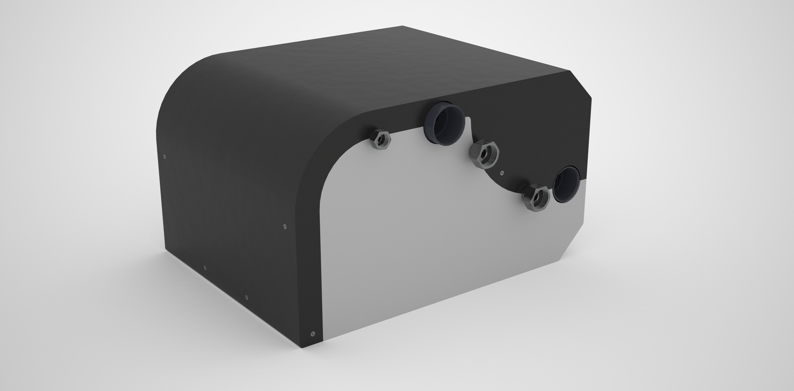

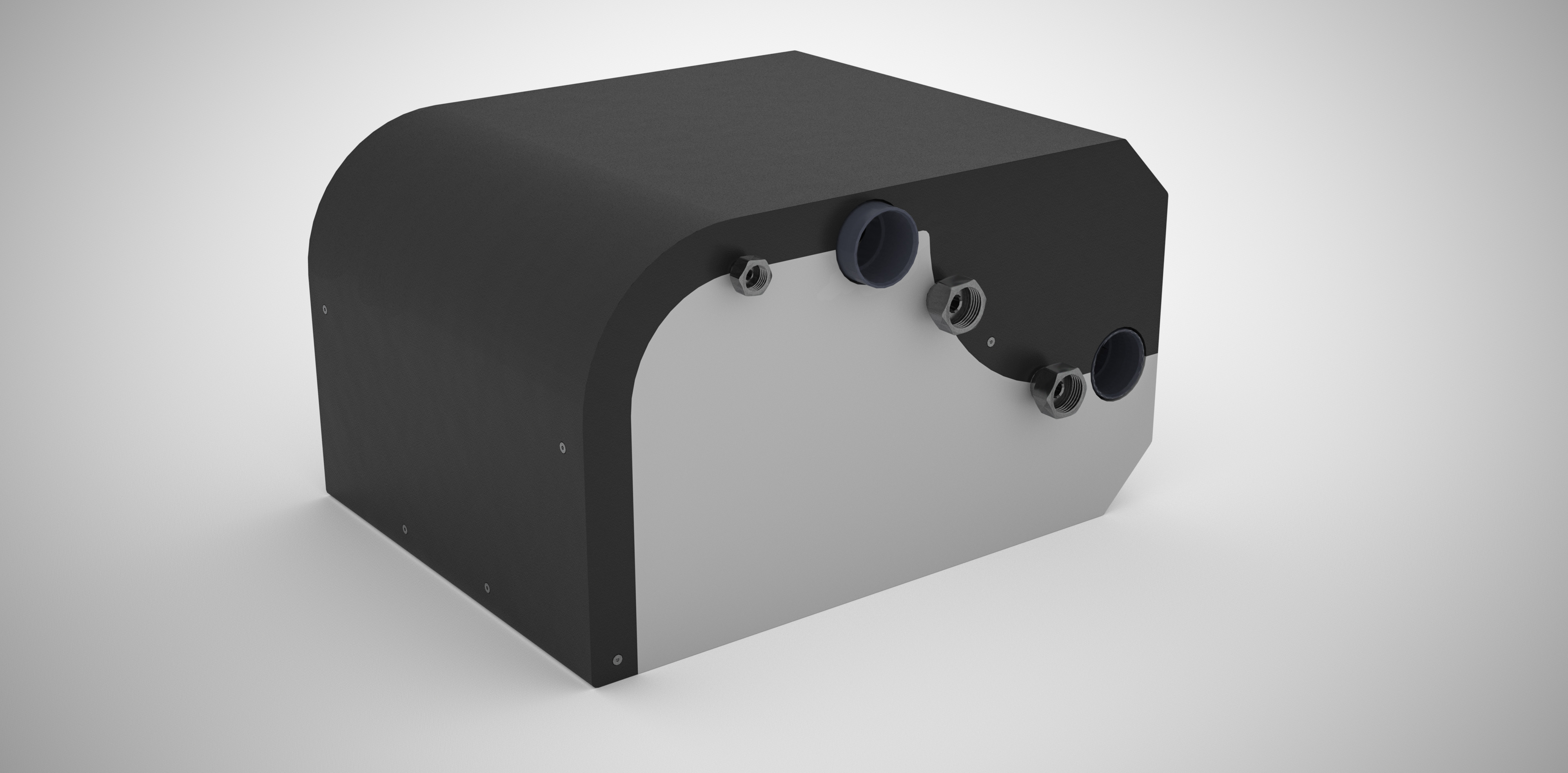

Ok here's what i got to date. Obviously, frequency of the noise shader matters when it comes to this bump issue.
You can also try to offset the outer profile Edges if you're working in SketchUp. You can do that with a plugin called ToolsOnSurface by Fredo6 on the SketchUcation forums. Or you can stamp a rectangle into the surface and hide the Edges, then export. That should make the triangles smaller.
Thanks I'll try this later, I don't have enough time right now and using some photoshop i can get a mixed image of both bump shade frequency without all the trigangles thing, so it's ok to me so far.
photoshop mix
high frequency noise bump shader -- triangled render
low frequency noise bump shader -- OK render

I downloaded the file and see the issue at the front. If you draw some rectangles around the screws that should fix at least some of the issues, but I can't say for sure. If you turn off the bump feature in the material used the issue should resolve itself altogether (you did use bump on it, right?).

Post by CTZn » Thu Nov 08, 2012 7:24 am
bioman666 wrote:Ok here's what i got to date. Obviously, frequency of the noise shader matters when it comes to this bump issue.
In fact when you change the frequency the height should be changed inversely (twice the frequency gets half the height).
One way to set bump right is to set the right-looking height ratio on a (very) low frequency version, then do the height maths for the final density.
From the render I can now say that the high frequency noise features are higher than their caracteristic width, if that's making sense. It's stretched really.
edit: I'll add this: you formerly recreated an Oren-Nayar-like surface, with a pretty high roughness. Probably beyond the sigma limits.
