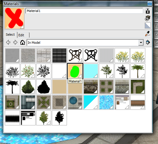

open you material editor, click at the material so that the paint bucket is used(or choose the paint bucket tool yourself) then under plugins->skindigo: material editor.
but double click must work?
make sure you double click on the materials where the green dot is in my Attachment picture, not where the red X is
