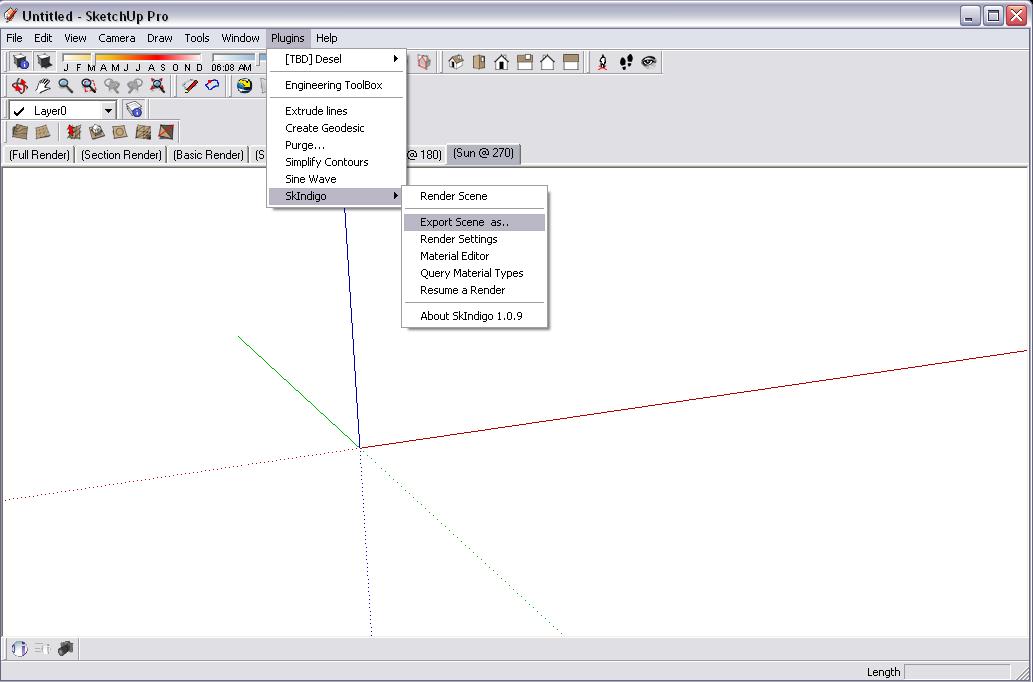

I'm not sure if I understand what you are asking. You want to change C: to \\master? Are you refering to where your igs file is getting saved to for rendering? You can change that by using the SkIndigo drop down menu: Export Scene As ... It will prompt you where you would like to save the igs. After you run that once, that skp file will always save to that same location whenever you hit the render buttons. (Excellent feature whaat!)
Hope this helps, Post.
do you mean igs and not skp? Is that a new feature? I'm running v1.1.5 of the skexporter.You can change that by using the SkIndigo drop down menu: Export Scene As ... It will prompt you where you would like to save the igs. After you run that once, that skp file will always save to that same location whenever you hit the render buttons. (Excellent feature whaat!)
Yes you are right. I would like to change the name of the c: (local reference) to Master (network reference) for the save path of the igs files. for the rending exporter. I keep getting errors from the slaves that they are unable to fine the files... I belive that the master is telling them to look locally on the "c:" when the file is on "master" so I have a batch file made that I keep changing to suit the name of the file. Just trying to automate more.You want to change C: to \\master?
Thanks
-Post-
oh yea, maybe that wasn't the clearest explaination. :/ sorry.
lets say you make this new scene in sketchup and you want to save it. you click save and sketchup asks you where to save it to. from that point on whenever you click save it goes to that location (unless you use the save as option and change its name/location.)
the same feature is available for your igs file output. if you refer to the image ive attached below, by using this option you can change where your igs file is saved (incase you dont want it in the default <indigo_path>\ location) so if you click on export scene as you can then choose where to save your igs file. so all you have to do is save to you base share location (\\master\) and you're all set and accessible by your network slaves. after you set the location once, you dont need to use that export scene as option anymore, whenever you click export (or quick export) the igs will automatically go to that spot.
better?
better?
