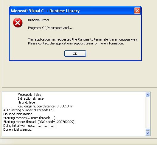

I am using Skindigo 1.0.5 and Indigo_v1.0.5.2
Export took 9m39s (at 1000x600 wide)
IGS file is 249mb!!
Then render crashed even before starting..:(
SU file is fairly huge at 31.4 mb
any suggestions?..:)
I do need final render at 2000x1200
Earlier, I was using Skindigo 0.9 stable...but export didnt finish for 45 min before I stopped it.

This has been discussed before here:
http://www.indigorenderer.com/joomla/fo ... =ram+error
There were some ideas about turning bidirectional on or off to fix the problem. Maybe that's a start.

so it turned out some high poly components were causing problems (at least partnering in crime)!
I recreated those as low-poly and things started to fall in place.
now export takes only 44s
.igs file is 11. 5mb
and no crashing!!
..and also used instancing
didnt mess with biDir for now...using bidirPT.
