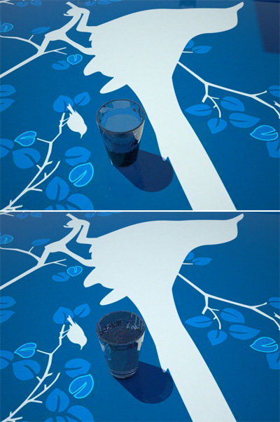

I made two tests with the last Indigo (v7.0) & Skindigo exporter (v0.7.1).
It’s a simple scene with white background, physical Sky enable in export. Two differences between the renders :
Top with a single plane for water and bpt off / Bottom with an object (cylinder) for water and bpt on.
Glass with ior=1.52 and water with ior=1.33.
My regrets : no caustics projection on the “birds plane”. Cauchy Dispersion Coef. error or something else ?
This post is a "clone" of an other forum post I made (guess which...).
(edit)I mean an other forum from an other site...

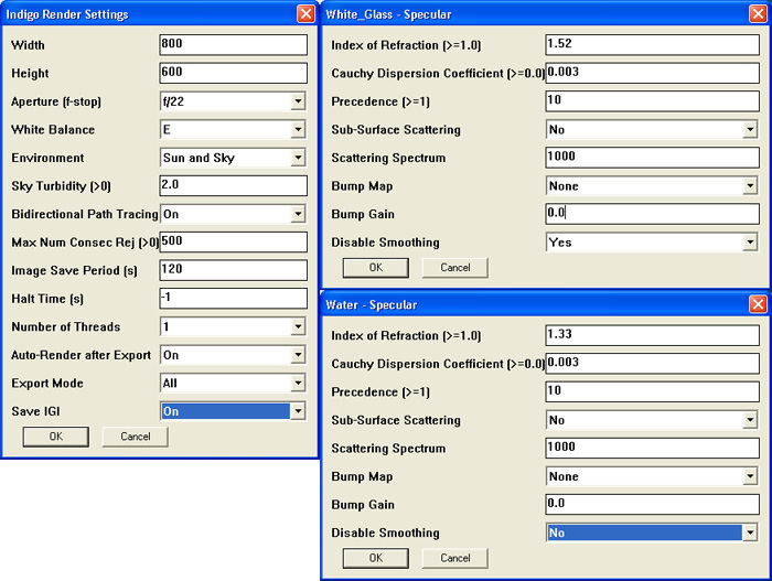

The settings...
SmartDen
Posts: 999
Location: Canary Islands
Post by SmartDen » Tue May 15, 2007 3:10 am
Set "Max Num Consec Rej"-parameter up to 1000 or higher. And have in mind, the caustics comes later with sun light.
Post by suvakas » Tue May 15, 2007 3:23 am
SmartDen wrote: And have in mind, the caustics comes later with sun light.
With bidir on the caustics should be instant with sunlight.
