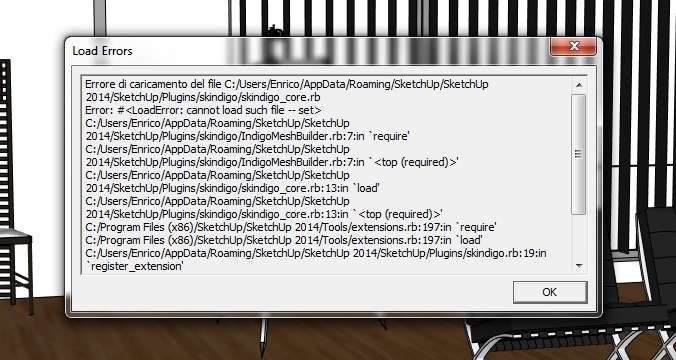

Hi Ono! The new Skindigo version is so faster but there was a problem. If I try to open a file with the 2014 version of Sketchup, the program doesn't load Skindigo's toolbar. To avoid this problem you need to open Sketchup 2014 and start the desired file from the Sketchup Toolbar "File-->Open". If you follow this procedure the problem seems to be solved.

Hello there,
I hope this is the right place to write this: I have the same problem as Enrico, and it has been going on with the previous version of Skindigo too... Opening the file from the Sketchup menu doesn't completely solve this, because this way I lose all my saved POVs and all the custom settings in the indigo menu. Also, I'm working on a very large model right now, so importing it to a new file 90% of the times makes Sketchup crash.
This actually doesn't make it impossible to work, but it doubles the time I have to spend to set everything again every time I have to make a change to the model (which happens almost daily).
I work with SketchUp 2014 (v. 14.0.4900) on Windows 7, and I use SkIndigo 3.6.28.1 Released 12 May 2014 with a commercial Indigo RT v3.6.26, Windows 64-bit build.

Re: SkIndigo 3.6.28.1 (beta)
Hi,
This is a SketchUp bug that should be fixed in their SketchUp 2014 maintenance 1 (M1) release.
Edit: Here's the bug they fixed:
"Fixed an issue where launching SketchUp by doubleclicking a skp file on another drive
would corrupt $LOAD_PATH and render the Standard Library inaccessible. This bug
caused many people to run into plugin loading problems if they were opening files located
on drives other than their “C:” drive."
Edit 2: Just tried the Maintenance 1 release candidate, it does indeed solve this problem.
The problem persist!! I wait the next update
