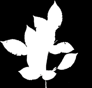

Post by tar_gniK » Thu Nov 22, 2012 12:01 am
That would work too, but regardless of whether Indigo supports png transparency, it is just easier just to make a black and white image, and apply it the clip map channel of the texture. The first image of the model shows the image has got an alpha, but using a clip map eliminates doubt.
Does not take longer than a few seconds to do. Example:

Post by CADMonkey » Thu Nov 22, 2012 12:29 am
Tar,
Ahh yeah that looks locigal...
I knew there would be better ways. This would save me from having two materials to maintain.
So how do you apply the green canopy material and the logo to the face?
I guess it would be a blend (advanced stuff not played with much yet)?
