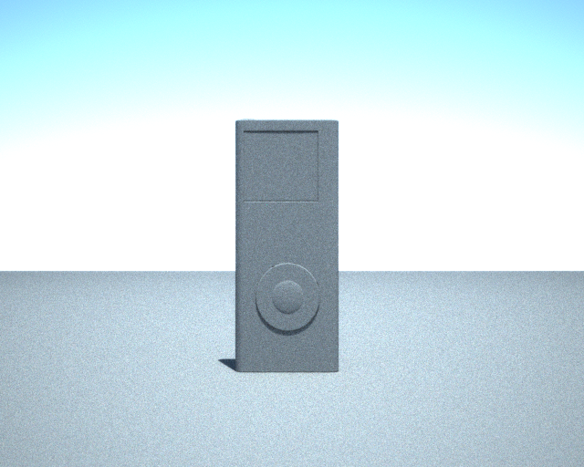

OK... I have encountered a little strangeness here..... (got UV-Mapping figured out, by the way. Thanx, guys).
Check out the iPod screenshot from within Maya and then look what Indigo produced. I am refering to the iPod screen here - in the Indigo render, it is way off center. Whats up with that?
Using the latest MtI 0.9 with the SVN update. I can provide the Maya scene and/or Indigo XML if needed.

ok.. finally a bug report !!
I have a few questions, if I may.
1. Which exact revision of MtI were you using?
2. Was the export process aborted at any time?
- The newest code uses a new method for exporting objects whereby they each get temporarily moved to the origin (and then back to their original locations). If the process is interrupted, objects can be left there.
[As an aside, I would like to hear suggestions as to how we might be able to avoid this problem - this occurs particularly if you choose "cancel" to the "File exists, Overwrite?" prompt.]
3. Are any of the ojbects parented/grouped/constrained to any other?
4. Are any of the translate attributes locked on any object?
(the code mentioned in Q#2 above won't be able to move the objects about if translate is locked, the exported object will then render with an offset in the opposite direction to it's translation)

As I really have no idea what you are saying (too technical - I just like to model stuff and make pretty pictures...), I am including the maya scene and xml output.
Using Maya 8.5 (linux x64)
Indigo 1.0.4 (via wine 0.9.47)
MayaToIndigo09_20071129
MtI-svn-rev173
As a side note, I seem to have heard issues with other Indigo scripts exporting scenes with no mats - maybe this is why? I will add mats later to check it out. I dont think the script was interupted, as I got a finish status in the status area at the bottom of Maya. Also no objects are tied or grouped together.

ok, the scene file is useful. having a look now.
edit: yeah it renders the same here. very strange. i can't explain it yet.
edit edit:
Freezing xforms has no effect (they are frozen already)
Deleting all history has no effect (there is no history)
There's nothing wrong with the exported .obj files either - if you re-import them 1 by 1, they come back in exactly the right place.
Also, grabbing the parts from the scene you provided, and translating and rotating them has no effect.
I think we could file a bug report against this one
