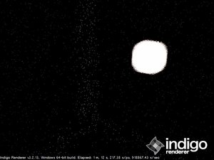

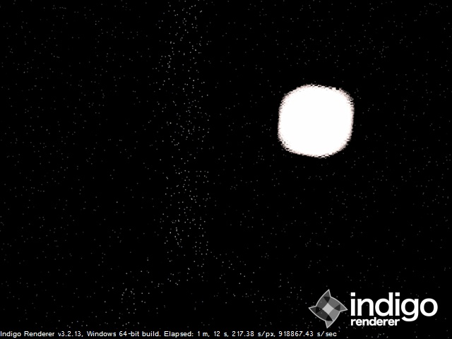

One of the problems was that when I exported the scene for render, some of the objects started so disappear from the scene in maya. The pivot point of the objects started to escape from the object as I clicked render and the dimension handler was not in the same place of the position handler. After several render tries the object was not there. No handlers at all. Maybe It has escaped to the infinity. I had to delete the object in the outliner.
I started a scene from scratch, a simple scene, a small cube with a light material and a bigger diffuse white cube that will make the walls of a room illuminated by the small cube, just to see how things are.
The walls simply did not get illuminated. Only some random sparse points appeared in the almost black scene (I was using reinhard), no mater what indigo version I use.
This seemed to be overcome if I put a very high lumen emission value instead of watt/m2. It must be some error on the emission value export parameters.

ior wrote: I started a scene from scratch, a simple scene, a small cube with a light material and a bigger diffuse white cube that will make the walls of a room illuminated by the small cube, just to see how things are.
I tested with all MtI 3x+ and all seemed to have this behavior.
I made some tests with an old scene and this behavior only persists if I use a new scene, if I use the old scene, it works fine. I do not remember what version of indigo I used to create that scene.
It is strange because when I use the new scene, the more lumens I put on the light source , faster the scene seem to be rendered.

But the sparse points in black background as if the render is very slow when emission value is small, still happening.
Very strange. Looks like an indigo bug. What parameters should make indigo behave like this?
Here is a render of a big diffuse white cube interior with a small cube illuminating it:
It rendered for a minute and looks like it rendered for a second

You should connect an indigoSpectrum as base emission. The default type and value should do fine: blackbody with a gain of 0.01W/m². The blackbody's gain is ignored if you use a different measure.
The issue is that a few samples from the sun are passing through the cube edges and are killing the Reinhard evaluation.
Sun + weak light + Reinhard tonemapping = bad mix.
You can also disable the environment to address the issue in this case, or use a different tonemapping scheme wich I would recommend. The Reinhard tonemapping can be excessively deceiving.
