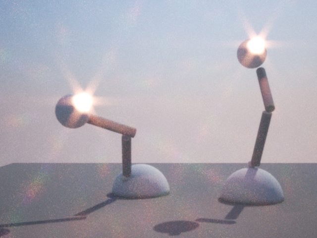

Post by CTZn » Mon Dec 22, 2008 7:17 pm
Well you pretty did all what could cause the issue, no wonders XD
Scratch that, unlike with instances freezing transforms actually helps with groups and MtI. I don't see myself adressing that issue right now as I've hardly designed something in MtI, but also I could not reproduce the error (I did freeze transforms).

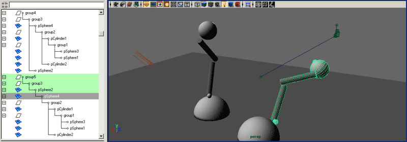

Maybe you can take a screen cap of the expanded Outliner for one full group (without shapes) ? I tried
group1
|-group2
|-group3
|-group4
and
group1
|-group2
|      -group3
|           -group4
with 2 objects in each group (group2: base: 2 spheres. group3: arms: 2 cylinders. group4: head: two spheres. Actually that may differ in the pics below). In the image following, the original model is at the right and the copy has the arm group parented to the small sphere right between the base and the arms; I didn't represent that scheme above, here's a screen cap of the outliner too.
omg they've got blasters !
massively frozen scene
