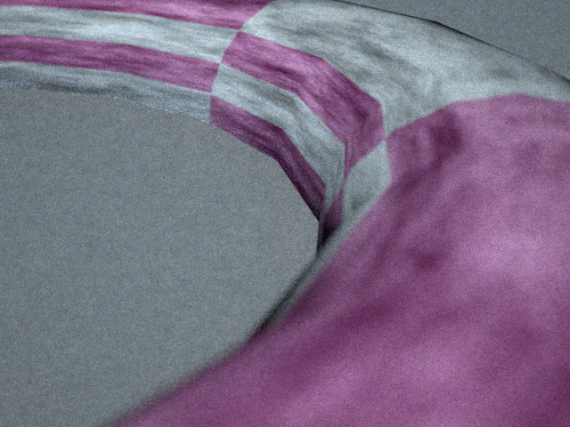

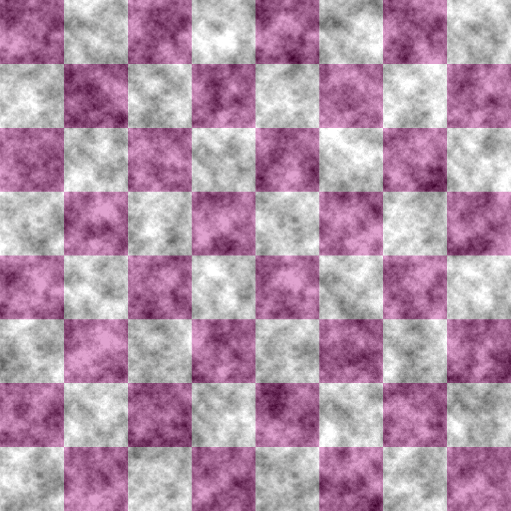

There is also the command compositeTest X Y;, X and Y being the resolution. This command takes no more arguments I believe, you have to select the swatch and execute. the result will be exactly what the swatch displays, so it's perfect with 2d textures.
I can't get rid of a camera-based artifact when using convertSolidTx, did you find a way to avoid this ? Or we will have to export with the IndigoCamera pane active...

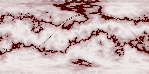

Thanks to your question I checked again and the issue appears to be limited to: marble, brownian and cloud (3d textures). Just display as textured an object having one of these in the color slot, thumble the view a bit and you should see a circling artifact. If you come to refresh the texture again (by moving the 3d placement for instancve) the seam will disapear... to the next border, that is where the facing ratio between object surface and camera is 0 (tangential).
Otherwise it's working well !

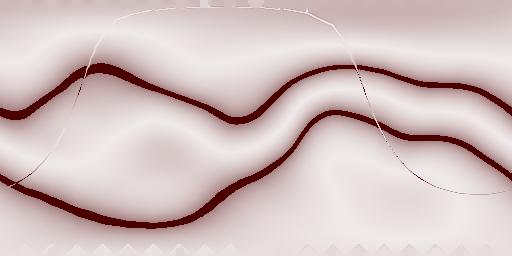

edit: I think it's the noise ratio wich is weighted by the facing ratio, in fact I remember now that was already happening in Maya 3.0... still I have no certitude about the origin of the issue. BTW can you reproduce this ? Note that the artifact aspect is defined by the camera orientation, I'm doing another one for comparison.
edit2: lol my demonstration about png is really awesome isn't it ? I juste realised that png was indeed not in the list :mrgreen: But the command works (-fil png), I've checked the image file header, I'm affirmative !
Same command, different camera position. Ah oops I played with the texture ratio in between ! Still you can see the prob...
convertSolidTx -rx 512 -ry 256 -bm "extend" -fil jpg -fileImageName"myTexture.jpg" marble1 pSphere1;

but the artifact is tangential to the camera view? so it's visible on the object or not?
Post by CTZn » Fri Dec 28, 2007 12:59 am
It's NOT visible if the Indigo camera viewpane was active when exporting, only issue is if you want to avoid this when animating you have to recompute the image for each frame. Also that would be visible in reflections.
