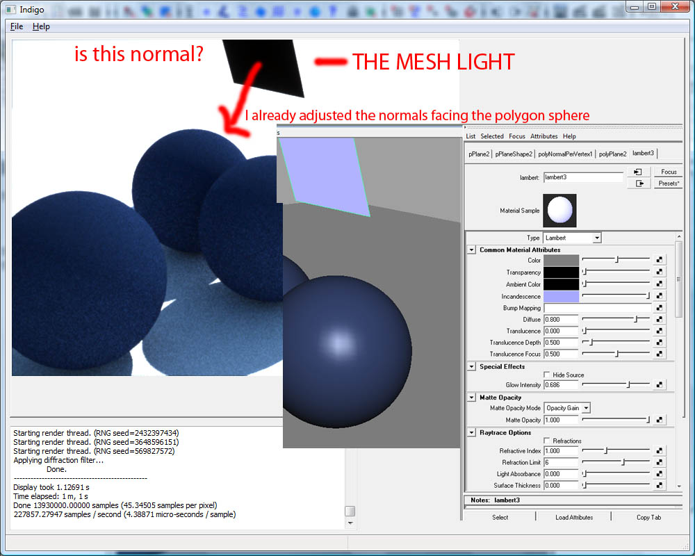

I already tried the meshlight but is it really normal that the polygon will be colored black? i adjusted the incadescence and the glow intensity. i already adjusted the normals as well but still get a black colored polygon[img]D:\meshlightproblem.jpg[/img]

Post by dougal2 » Thu Jul 17, 2008 3:10 am
Are you using sunsky as well in that scene? you will find that the sun is so powerful that it overpowers all meshlights and they appear black.
Change the env type to "none" to see the effects of using meshlights only.
Or increase the glowIntensity of your meshlights up to several million (or so, I don't know what the value is, but keep adding zeros until it works).

thanks guys! already got it. got one more question though! how do you change the color of the meshlight? for example i want to change the light color to blue? where do i change it? r=40000 g=? b=?

Post by dougal2 » Thu Jul 17, 2008 11:20 am
meshlight colour should be settable by the incandescence colour.
