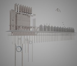

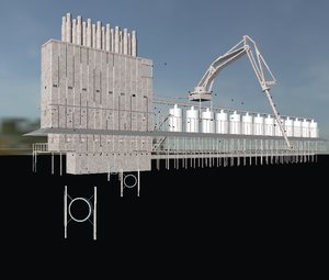

I'm working on my final diploma project studying architecture and I've started to have serious issues in some of my scenes. When rendering large portions of my scene disappears. Depending on what I turn on and off in C4D, different things aren't shown and are cut off oddly. I've attached some images showing what happens & a screenshot from the editor of what should be shown.

Nice catch! I had this bug once a while ago I think. Could you upload the scene for the developers to look at?

Re: Geometry disappears when rendering
Hello @blomfelt nice to hear you going with Indigo for your diploma project.
Your issue inside C4D seems very familiar to me..did you use a cloner as a base for your setup?
Try to make the cloner editable and see if it helps with the issue.

I'm an idiot and forgot to mention that the basis for the model was built in Sketchup Pro 2017 and then imported which obviously always causes a huge mess. I spent an hour cleaning it up but there are still loads of nested groups. We've recently switched to C4D for a lot of the modelling but some of the earlier models were done in Sketchup before we realised how good the integration is with Cindigo and how C4D handles lots of polygons without breaking a sweat. I've attached the scene, I'd like to understand what is wrong before I keep working on it.

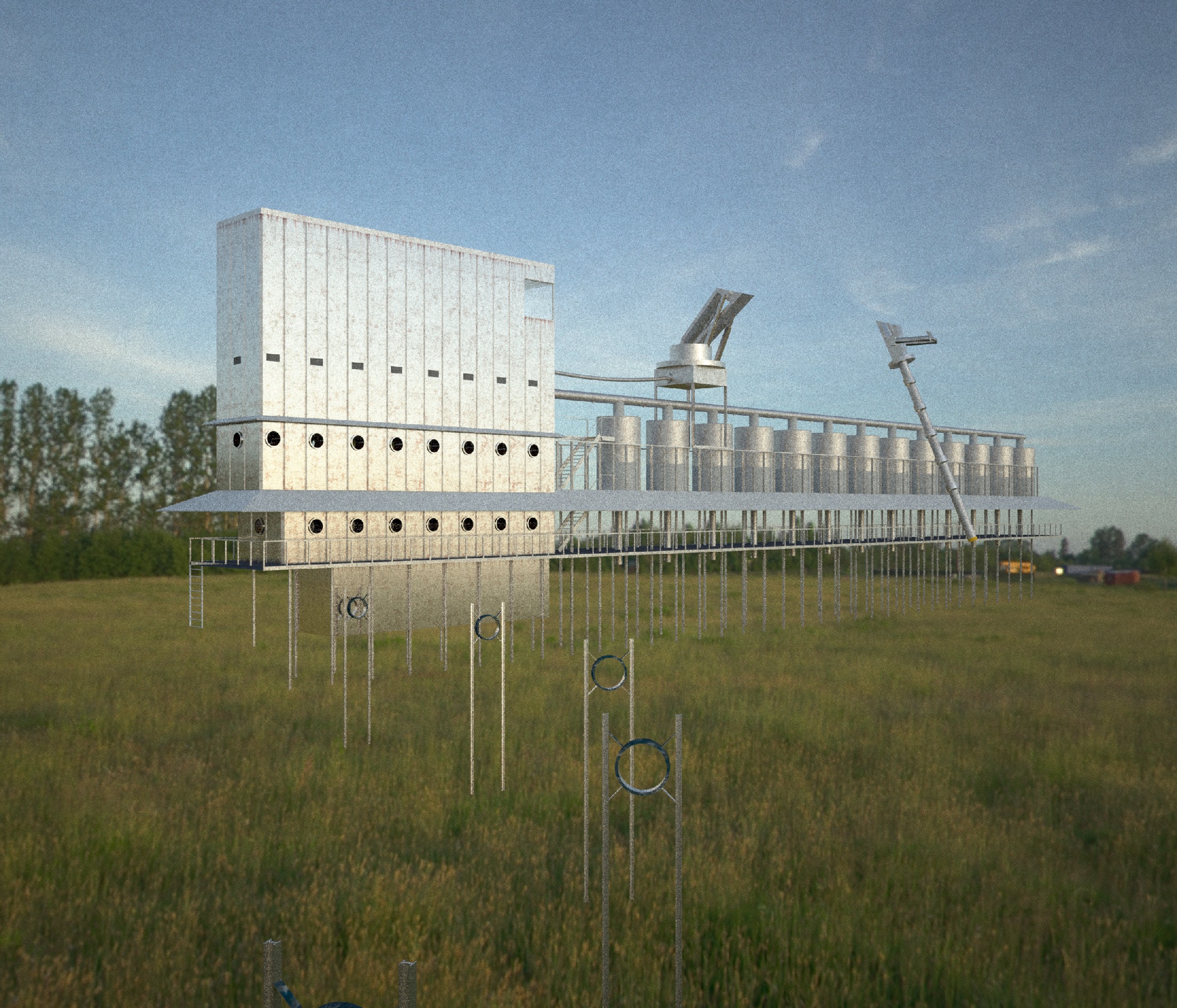

So it seems like the problem was due to how C4D handles the import of Sketchup files. When I export a .3ds from Sketchup and open that instead it renders without an issue.
