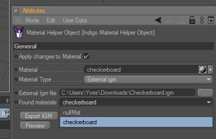

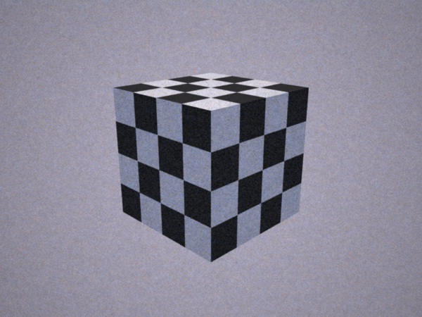

ive been working a bit on the external igm feature.
it works like this: you select an igm file, which is then parsed. you can select any material within this file from a drop-down list.
edit: pics
using checkerboard as external material
looks like this
